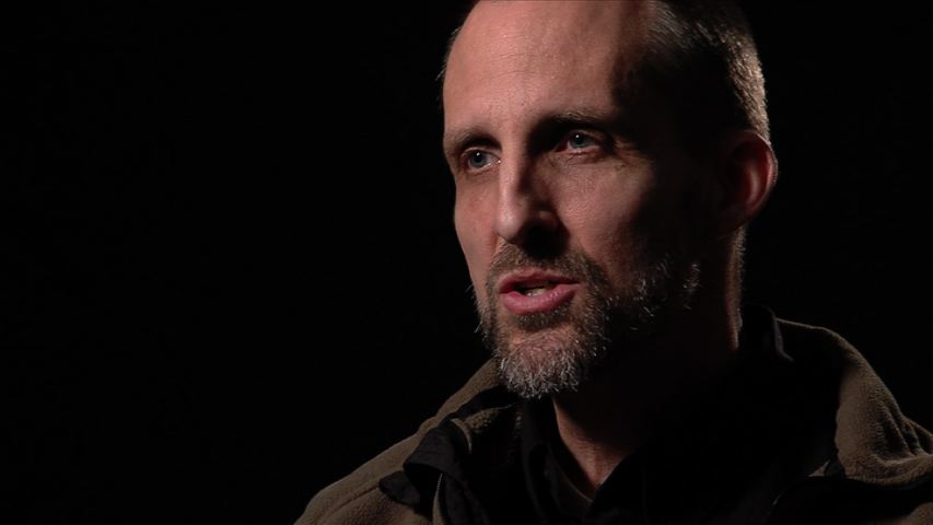

What are you wanting your black background to look like? Are you thinking totally black? This is what I did recently for a shoot... probably a 30x30' room, my subject about 6-8' from the black background with a 1k light as a key. My black background was a black cotton cloth that I bought from a photo background selling on ebay. The key for good blacks are keeping light off the background. A bigger room helps with this as you can get your subject further away from the background.
And yes, I know there is microblocking in this image. It should disappear when I actually color correct the image and push the blacks down a little.
Matthew

Matthew, what is microblocking? I think the image looks great ;.

If you look at the left side of the image you will see small blocks of black and not so black blocks. It basically has to do with compression and how badly it handles blacks sometimes.
To be honest, that's not really going to help much with your sound as your subject is facing the opposite direction. The sound is still going to go out from the subject, hit the wall, bounce back towards the subject, be picked up by the mic and then be absorbed a little too late. Your best bet is to build a "box" out of blankets around your interview space. But of course, a lav is FAR better for doing interviews. I use a shotgun also 90% of the time, but it's only for backup.
Matthew
So it's really reflections off the wall behind the camera, not behind the interviewee, that cause the most problems?

It really depends on what kind of room you are using. If it's got carpet in the room, that makes a WORLD of difference. But I find that a blanket in the direction that the sound first travels helps greatly.
So in the case of the shot above, hang a blanket behind and to the left of camera; so his voice would be projecting towards the blanket. Correct?
