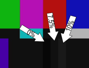

Learn to use the zebras in your PD150, and expose caucasian face highlights to at least 70ire. If you search the PD150 forum on "zebras" there should be lots of information on this.
Not sure why you're using the CTB gels? If you're looking to just go a little blue, you can do that with post color correction, or, adjust the look a little colder in the Custom Preset menu in your 150.
It's far too easy to turn up the brightness on LCD or monitor - this will fool you into thinking you have good exposure when you don't. For a rough brightness setting:
1) turn on the colorbars on the camera
2) Referring to the attached image, look at the lower right of the bars.
3) The left-most, marked 0%, should be black.
4) Adjust brightness to make the 7.5% bar black as well, indistinguishable from the 0% bar.
5) the right-most, marked 10%, should be barely brighter than the other two, a very dark grey.
Your monitor is now roughed-in. This will change, depending on ambient light, so it's a good idea to check this when you light.
There's a lot more to a full setup of your monitor, but the above should keep you from gross under-exposure. Even still, you can't trust it -that's what the zebras are for.
