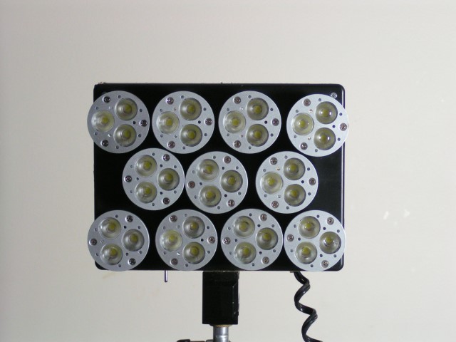

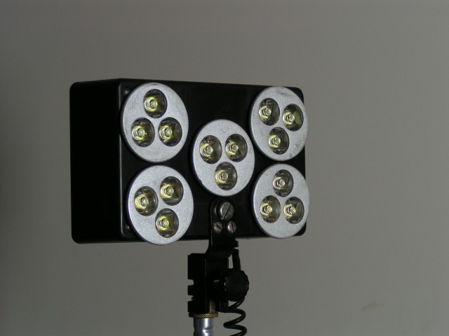

Richard, I've included (attached) 2 versions that I use. The 5 led I keep in my camera bag and the 11 led I use to support my main lighting package. You can switch on either 1 or all 5 leds on the 5 and you can switch on 5 or all 11 leds on the 11.
According to cree, each led puts out 50 lumens, that would be 150 per mr-16 and 1650 for all 11, probably equivilent to a 100 watt bulb.
The strange thing is that output is pretty strong and beam width is somewhere between a tungston and a fluorescent. The power is quite remarkable. I have used the smaller version (in a pinch) in a restaurant to shoot a German Band. At 15 or 20 feet is was strong enough to change the white balance to daylight. Is it possible that the camera sees much more led output than we do?
Gary
Gary
Absolutely. White LEDs are manufactured from NUV (near-UV) emitting LEDs, usually with some rare earth elements to produce a "lunar white." Film and video are much more sensitive to UV light than the human eyes are.

Old February 19th, 2008, 12:00 PM   #14
Join Date: Jul 2005
Posts: 110
Wow Bill, those lights would have to put out about 10,000 lumens to be equivalent to 500 watts. They must have quite a recoil when you turn them on! Did you pay $450 each? I have tried many types and styles of LEDS but I'm not sure I love them that much LOL. By the way, LEDS can come in 15 degree, 30 degree, 60 degree and 120 degree. I have found the 50 ro 60 is pretty good for 10 to 20 feet. If I need to get closer I turn off lights or diffuse.
