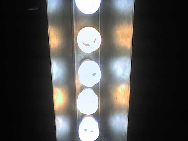

Old March 9th, 2008, 03:49 PM   #4
Location: Elberton, GA, USA
Posts: 6
CFL's and color temp
I just got done fooling around with a homemade light (got the case from the Habitat store for 5 bucks). After playing around with the various types -- daylight, soft, etc., I noticed that 3 daylights and 2 softs in the same box come in at about 3400 K.
Anyone ever tried mixing and matching same wattage bulbs of different types to get a specific color temp?
Anyone see any problems with that?
I have attached my light. Still needs some refinements. Mainly reflectivity.
Mark
