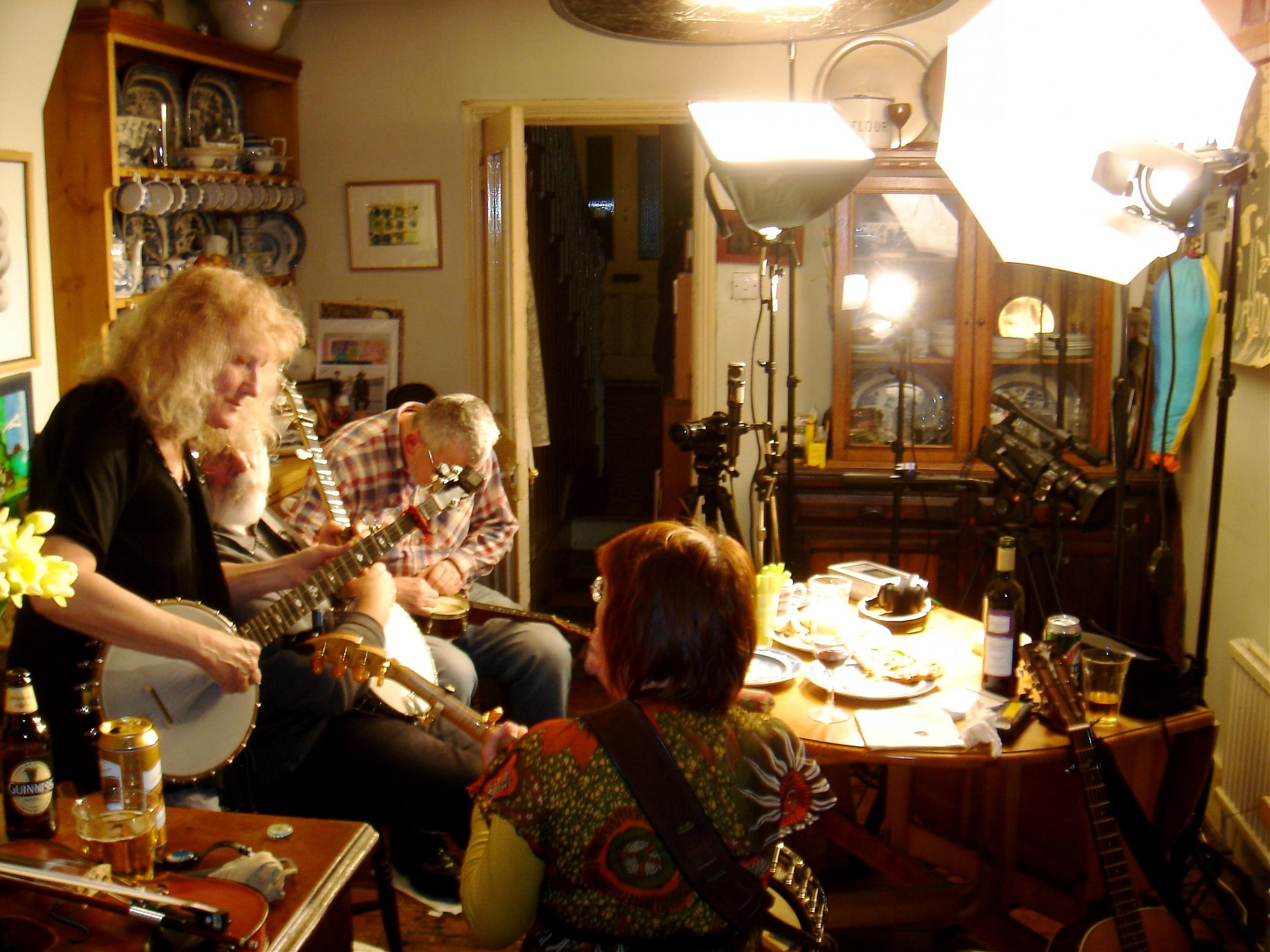

I used the following kit, pictured:
Lowell Rifa
Lowell V Light (with umbrella)
Lowell Prolight
two Arris (650 watt I think, one is behind the rifa)
One Lastolite reflector (on ceiling)
I wanted to create a warm intimate atmosphere. Pools of light. Not obviously lit. It's friends in a kitchen.
There was a highlight on the forehead of the banjo player on the right.
Do you think I would have got better results with a Kinoflo and Dedo lights? In which case I may rent these the next time I do anything like this.
Thanks for looking.

That done, you have a pretty small space there so it's tough to light--whoever is closest to the fixtures will be much hotter than the next person. You will also want to keep the walls as dark as possible to focus attention onto the musicians, create that intimate mood and further simplify the frame. For this reason, you need to be careful with your frontal and ceiling bounces--you've lit everything from camera position so there is no dimensionality to the light.
What I would personally do is place a soft source to the left, behind the foreground guitarist (the Rifa, if you had room for it, or a bounce card against the wall lit with a 650 on a low stand). This will give you a beautiful rake across the three banjo players. You may have to arrange them so that the lady in the middle is not shadowed. A flag would be good on the upstage side (away from camera) to keep the light from spilling onto the side and back wall.
Next, a low soft frontal fill--either another bounce or Rifa, between where your cameras were positioned in that picture. It could be at or below the table level. You may well want to lose the table in any event, or replace it with a smaller one if necessary. This will give a subtle amount of fill to the musicians, particularly the guitar player on the left, without heating up the back walls too much. This could be gelled warm, perhaps a 1/4 CTO, or just use a warm bounce (I think I see a gold flexible bounce on the ceiling?)
Consider bringing a small table lamp from elsewhere in the house and place it in the background to add a little contrast. Put it on a standard household dimmer and adjust it to eye so that it is not too hot. Then you can take your little Pro light and work it from the side onto the rear guitar player, to pick him out a little. There's not a lot of places to hide that light, so you might be better off with a slick little trick such as this: take a small household bulb and socket and find a way to cantilever it off the back off the table lamp (flexible wire like a coathanger, perhaps), then position it so that the lamp hides it from camera view, this will give you a perfectly believable sense of the lamp lighting the person. Some judiciously applied blackwrap (or alumimum foil if you don't have blackwrap) can help shape the light so that it doesn't spill onto the back wall. Of course make sure that the bulb is not too close to the lampshade for safety reasons.
Finally, a small unit like a Prolight or Dedo clipped to the top of the shelves above the banjo player's heads, well-snooted to give a little edge light to the foreground guitar player. If possible, this could be on a short stand and hidden behind the banjo players which might be nicer as an uplight, which is preferable as his look is down rather than up. This would be well-motivated by the newly-placed table lamp behind him; it all depends whether the light could be properly hidden down there or not. A Litepanel or other similar small unit would be a great choice also as they can be taped up and hidden more easily.
This plan would deliver a believable and elegant look where everyone has a bit of edge light for snap and separation, but overall warm and soft. And again, it's just what I'd do off the top of my head and not seeing the space firsthand. The next person who posts may have a totally different lighting plan in mind, and it may be just as nice!

The problem with the ceiling bounce is that it scatters everywhere. If you had the ability to cut the resulting light off the back and side walls, you'd be on to something. This would require a teaser which could be as simple as tinfoil or preferably black fabric like duvetyne taped on to the ceiling, hanging down a foot or so in front of the bounce itself. By the way, no reason you can't just bounce off the ceiling itself and save your reflector and stand for something else. Conversely you can take your Rifa way up to the ceiling and point it down at the musicians, but again you need to be able to cut the light off the walls etc...don't think the Rifa has fabric eggcrates (does it?) but a set of flags would be required otherwise. A china ball is fine but it too needs to be controlled with a skirt around it otherwise you are blasting light everywhere once again.
The Litepanels are daylight balanced but they come with gels so you can quickly make them 3200 or even warmer as needed. With onboard battery, a great little light to hideaway in the middle of the set.
