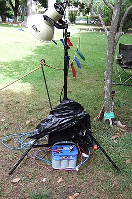

Even George's calculated estimates are too forgiving because batteries are rated at a 20 hour discharge rate. This battery will only provide 51AH if drained slowly. Assuming that something like two 650W fresnel are attached to this thing, you can probably only expect about 10-15 minutes of run time before the voltage drops too low to sustain the inverter.
"My three Flolight 500LED lights pull 40 watts each. I could run them for a long time."
Bill, since the LEDs would drain the battery at a slower rate, you should expect a few hours of service.
Battery operated fluorescent, LED, or HMI are a great idea if you only plan to run a few hundred watts. I run two 40W CFLs off one battery for hours. I wouldn't plan to run more than 300W on this Xantrex supply without shortening the life of the battery.
I am attaching a jpeg of one of my rigs.
