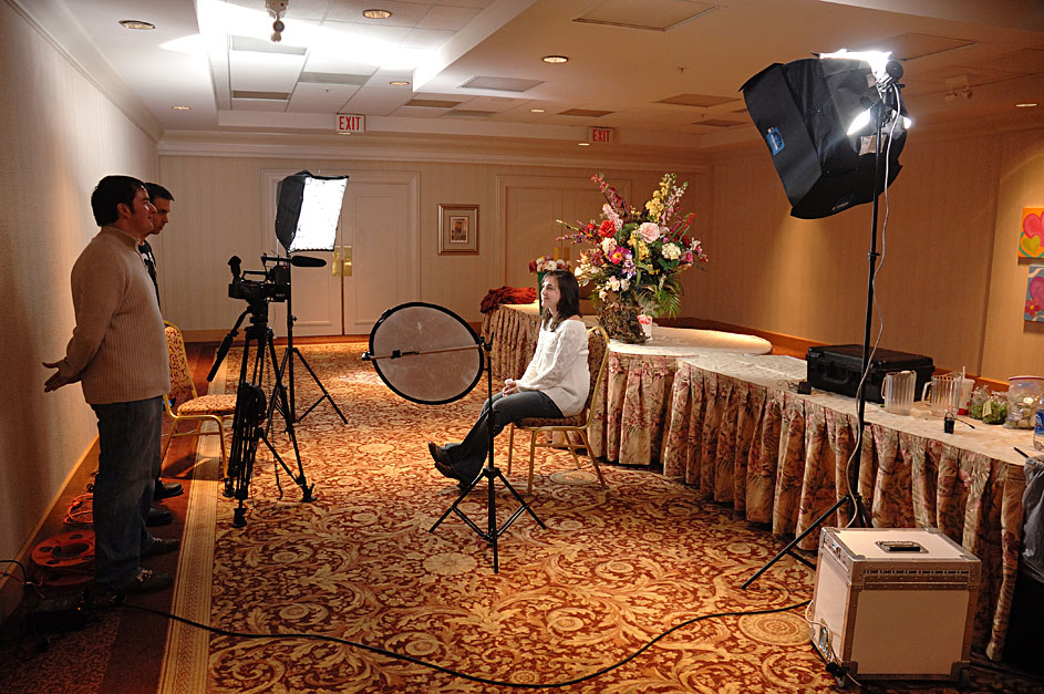

Check this out. Its a pic from a recent interview I did for the Stephen A Comunale jr family cancer foundation. We are still setting up the lighting, but you can see the chimera brand flags at the end of the softbox. The K5600 Jokers (200/400w) looked gorgeous with the warm accent lighting in the ballroom.
-John

What you're calling "flags" in that pic, I would call something else (not saying I'm RIGHT, but my brain thinks of those as barn doors or something).
To the OP-
The kind of flag I mean would go on a separate stand, in front of one of those softlights, just a short distance (maybe not even a foot) away for this kind of thing. Some people bring it in from the side, some people bring it in from the top. You sort of move it in and out, trying to find that perfect balance between cutting the light off the wall that's behind the subject, and cutting too much light off the subject themselves. And of course, keeping the flag out of the shot.

I guess technically they are barn doors (without the ability to focus like real barn doors). They give you a bit more control when a crate is not enough.
-John
