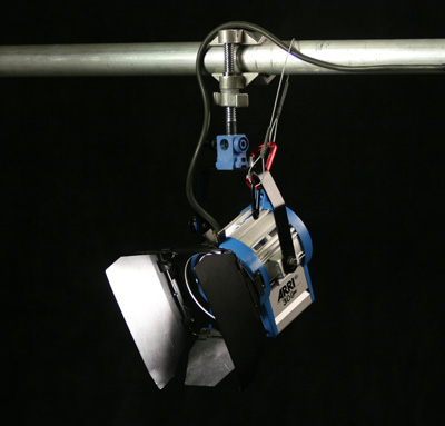

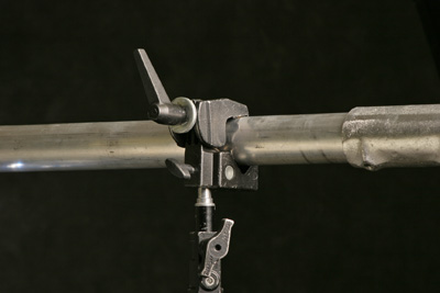

Rather than a conduit you can use a 3/4" (ID) galvanized pipe available in sizes up to 10' long at any home improvement stores, you can use threaded unions to extend the length. It's considerably heavier and safer to use and will not be crashed by the clamping.
Mount the pipe on the C stands with two Mafers or super-clamps available form Matthews http://www.msegrip.com/ or Bogen and you can also use the same clamp with a stud to attach the light the tubing or even better use a Matthelini clamp also available from Matthews.
If weight is a concern you can use 1.5 aluminum tubing available from many industrial suppliers like McMaster-Carr http://www.mcmaster.com/ search under structural framing, you'll also find all kinds of connectors that allow you to build anything you need.
