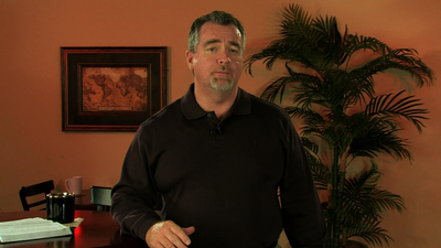

screen grab...
Just a quick grab from the project we're discussing.
I'll post more when I'm done editing.
Mike Watkins

Thanks for sharing, Mike.
If I'm not mistaken judging by the reflective shine on the subject's face, you're using a some fairly hard lighting to the left (also notice the shadow on the right side of the picture frame) and another hard light angled above coming from the right at about 9 o'clock. And looking at the shadow cast from the fern tree, it seems like there's a substatial soft light coming from the lower right near the front of the camera.
The light on the left does give a bit of definition on the subject's right shoulder. The key to fill light does not have much of a contrast ratio - perhaps 2/1.
Perhaps the pix has an intensity problem - the subject's brown shirt is very dark with little illumination.
In summary, the facial light works okay. My main feedback would be to work on the set design. Almost everything in the scene is a shade of brown or burnt orange. There's little contrast between the subject's flesh and the color of the background wall - even the prominent picture is the same color. My goodness, it looks sooo 70's - like the inside of my home! (fortunately my dog still loves me)
Thanks again for sharing.

Thanks Michael,
I'm in agreement with you on the brownish tone of the set.. We were going for a warm little "bistro/coffeshop" type feel, not sure if we got that across, sounds like we should have invested in a piece of green shag carpet ;-)
I used the vividrgb preset and realized when I was logging the footage in that the reds were off the chart...I didn't notice this in the viewfinder during the shoot. My next purchase may be a good field monitor. I'll search the forums, but would love to hear suggestions on a good field monitor for around $500.00 - $1000.00.
This shot has had some levels adjustment in post using RGB levels filter in FCP. I am considering running the project through Color to fine tune.
I most likely won't be reshooting the project, but additional comments are welcome so that I can implement them in future work.
Again thanks for all of the encouragement and critiques that are offered here.

I always said that photographer's best friend is a good monitor. As the industry is moving toward HD and LCD monitors you'll probably find some good buys on Ebay on an 8" Sony Field monitor.
On your shot I would have like to see more lighting separation between the subject and the set, looks like they both have the same exposure. In few words more light on the subject or less light on the background. Also when the background is so dull some slight light pattern would help. Also showing more background gives the feeling of space, right now looks like he was crowded into a small office, move him away from the background, move you camera a little closer and wide the zoom a little. Forget about the low depth rule like on interviews, this is not an interview.
I see shadows in every direction on the plant, meaning that you had lights coming from different directions. The basic light concept on anything is based on one single light, this is because the human eye is accustomed to see only one light source, the sun, and that casts one shadow. The appearance of a second shadow always gives an unnatural and artificial appearance.
Next time also move the plant several feet away from the wall, by doing so you'll have a better control of any shadow and you'll add another plane to the image thus creating more depth. Use some backlight on the plant in order to create better separation, always remember the Chiaroscuro principle. I don't know how to embed a video here, I'm sure there's a way but if you go on youtube and under search write: "chiaroscuro efplighting" I have posted a short video explaining in an understandable way the basic principle of the chiaroscuro technique.
Overall is a good start and you are heading in the right direction. Never be afraid to ask, the dumbest question is the one that wasn't asked.

A couple of things hit me almost immediately.
In no particular order:
1) Lighting from several directions for example highlights on both sides of the face and of almost equal intensity, diverging shadows on the wall from the plant.
2) Skin tone amazingly close to the color of the background - almost looks like everything had been spray painted the same color, including the speaker. I think you need more light on the speaker and less on the background. It might be a good idea to check the lighting in black and white to be sure there is adequate contrast.
For portable use, you'll find the classified forums/etc have reasonably priced monitors like the Varizoom LCD for under $500. Or, if you'll continue to work at studio locations and have a laptop, you might consider getting DVRack software (connect via your camera's firewire to your PC). And if your drive laptop drive is fast enough, you can record AVI directly to it. On my laptop, I use an external G-Raid firewire for studio capture. After capture, I reconnect the G-RAID drive to my editing PC. At any rate, in addition to serving as video monitor, DV Rack has all the field monitor displays you could imagine.
Videoguys Serious Magic DV Rack 2.0SD $349.95, DV RAck 2.0HD $499.95
