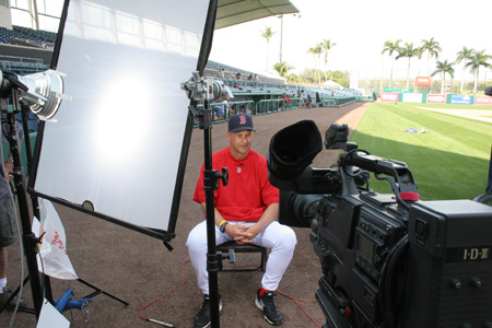

There are all kinds of diffusion material available beside silks. The grade of diffusion is usually rated by transmission F stop. The higher the stop the greater the diffusion. Some of the flexfills reflectors can also be used for diffusion.
Before Chimeras and all the diffusion fabrics available on the market today we still had to diffuse our lights and we also had to make our own frames. Use pre-packaged shower curtain material available at any department store or buy it by the yard at any fabric stores. Use the white for greater diffusion or the frosted for lesser diffusion. You can just hang it between your light and you subject by using something like a background holder or for something more permanent make your own frame out of 1x2 wood strips and staple the material to the wood.
Adjusting the distance between light-diffusion-subject will give you different results. Careful, although the shower curtain material has some limited heat resistance, keep the light at least two feet away.
