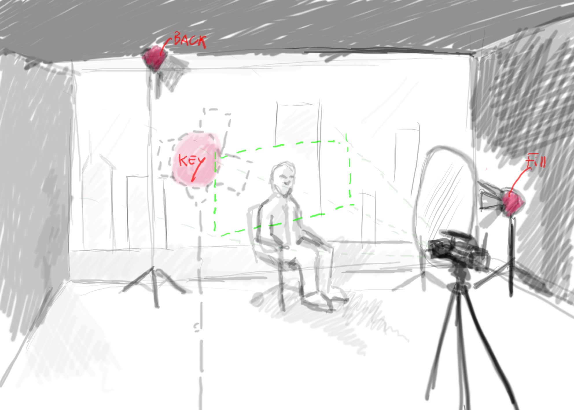

Thanks George. I probably didn't explain properly, but the BG is the city behind a large window. So basically the subjects sits in front of the window with a lovely backdrop of a daylight cityscape. I have done a quick rendition showing the setup.

Sort of missed that... anyway.
The 'standard' move is to gel the windows (CTO/ND) from the outside, but that's not always going to be practical. The problem is the (limited) dynamic range of the camera.
What you could do is shoot the window separately and shoot the talent against a blue screen (even on location) and composite the two together. Best to shoot the talent first and then shoot the same length 'window' footage so you keep dynamics/movement outside. Keep the camera position the same and locked down. Match the shotlist for easy editing.
I would gel the lights with CTB (or 1/2 CTB) and color balance for the natural light.

For this type of shoot where the shot is fairly confined (I'm assuming a standard interview framing from waist up), gelling the windows with ND would seem to be the logical choice. Since the glass is a relatively invisible factor in the equation of the relationship of subject to background (i.e. the background is the cityscape), you can move the talent pretty close to the glass, minimizing the amount of glass needed to be gelled. If this is the case you wouldn't want to use an 85ND, just a straight ND (probably a 9) since you would be mixing color temperatures with the ambient spill around the ND. Assuming that there is a significant amount of window in the room, the uncorrected glass portion will deliver a nice ambient edge on the subject that is likely more pleasing than can be achieved with a single lighting instrument functioning as backlight.
Another way to do this is to hang a double net like a 12x12 behind the subject, possibly even folded over on itself which will be somewhere between an ND6 and ND9 in effect. There will be the added benefit of slightly softening the background, but there is also a danger that the texture of the net will be readable on camera (and may create moire in the background).

The simplest thing to do with the lights you have is, as noted above, gel the windows. You'd need some CTO/ND gel, to drop the light down and make convert to 3200K. Probably about $150 a roll, but you can save and reuse it. If you can only get ND gel, use CTB on your lights.
The best technique to gelling windows is to have a straightedge and X-acto knife and have somebody who can do it cut the gel to within 1/8" accuracy. Take a bottle of Windex and an artist's squeegee or roller (like you use when mounting prints). Spray the window thoroughly, hold the gel up, and squeegee out all the bubbles. It will stay there for days. Some gaffers use a spray bottle with a very thin soap solution, but I think Windex works perfectly well.
