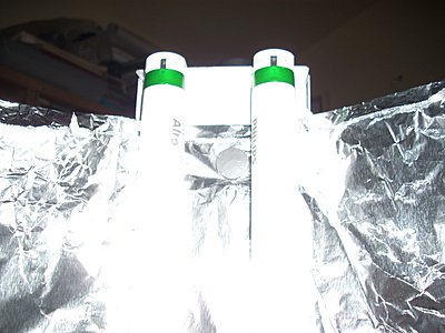

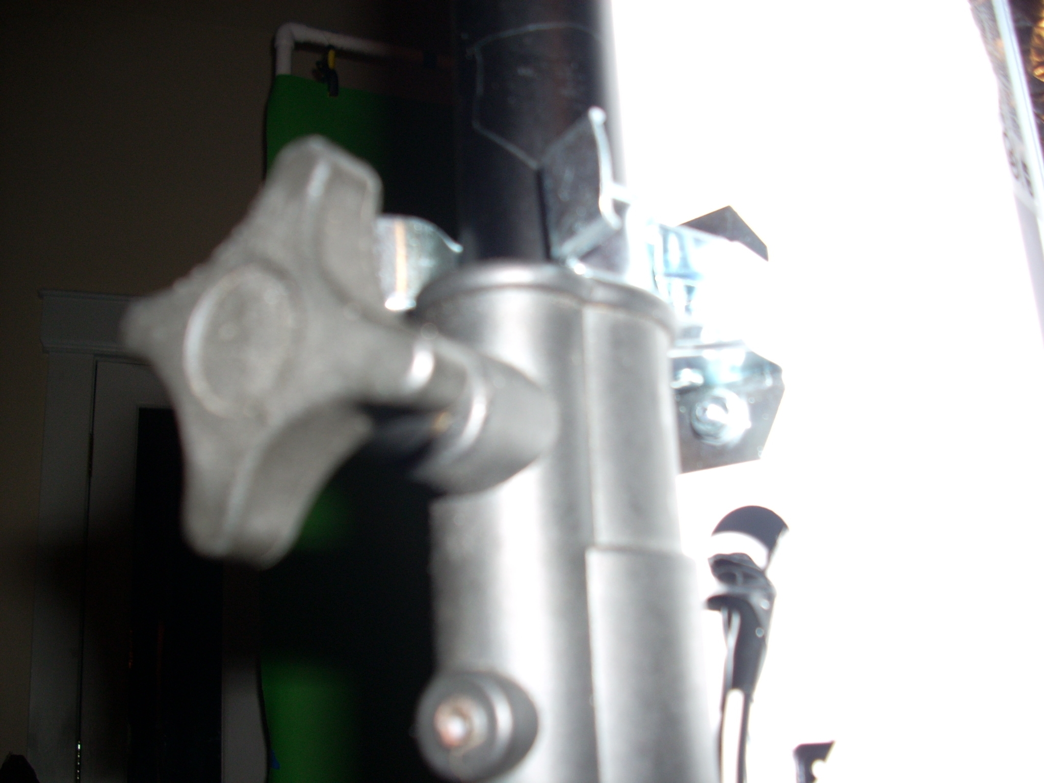

I attached some photos. Yes, extremely ghetto, I made these to last about six months. You can see the mop handle hooks attaching it to the light stand. Notice the fancy Reynold's Wrap barn door (need to crinkle it more). A couple of kitchen magnets make the foil stick on the fixture. In the bg is a DIY pvc greenscreen frame. It uses green photo paper.
