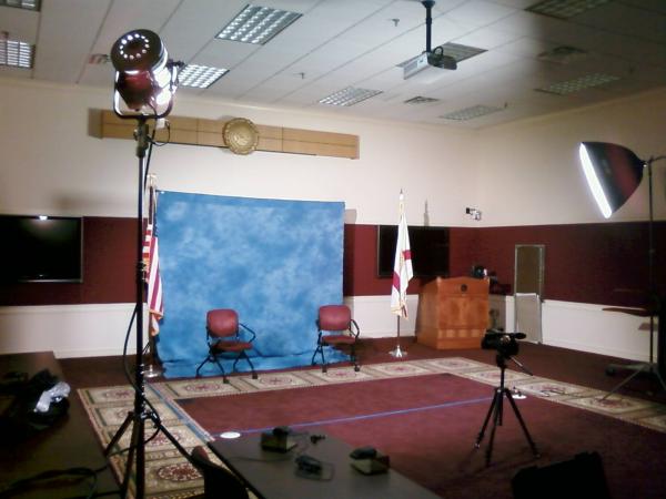

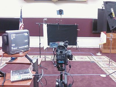

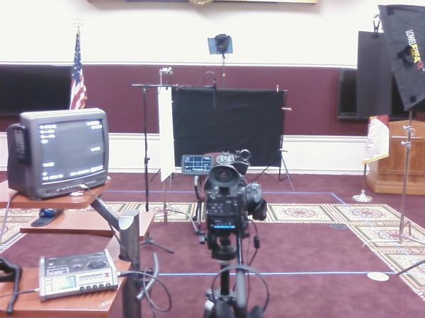

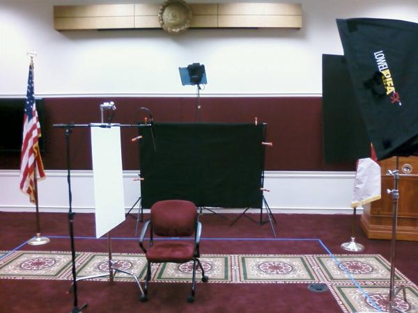

I've added some attachments from an interview setup in October. You can see in the 2-up I had my Mole 2k and Lowel 1k softbox, and for the 1-up, I had shots just before filming, so you can see the reflector, flag on the softbox, dp with CTB and diffusion as a hairlight, mic on boomstand, EX1 locked and loaded, and shooting dual system so my seperate 24 bit recorder. I am also monitoring video on a remote monitor.
Previous to the client walking in, he and I had only done quick run and gun setups with no light. His reaction walking in and seeing this was quite funny!

Funny you should mention that. The OP should note my attachments in the above post. Note that this was a "blackout background. So I had to use a flag to keep the softbox light from spilling onto that black background. Otherwise it would have been a crappy shade of gray!
These photos are deceptive. There is a LOT going on here. Subject to background distance, light angles, soft light, reflectors for a specific fill, separate system audio, hairlight that is NOT colored the same as the primary light so yoi've got to monitor color temp mixing, etc. Not much for a pro, but for a beginner like me, it was a lot to manage alone.

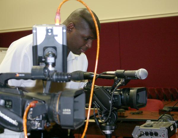

Would this be a good time to mention that it was a 2-camera shoot? Byron, you getting all this? :) We're there in the trenches with ya buddy!

ps. What's with the on-camera mic? I think I see a wireless receiver on the closer camera, I assume that's to a lav?

Oh, I was still alone. I just needed a B-cam to cut to. Ever try to cut an EX1 at 1080p With a DVX100? I stopped trying after an hour and just went with 12 minutes oa A-cam!

The SM58 on top of the EX1 was just there to get sync sound. I put one channel of internal mic on the recording, 1 channel of external SM58, and a boom mic running into the separate recorder. I didn't have my wireless at the time. The unit on top of the close cam is the Firestore recorder. I don't use tape anymore unless I HAVE to.
