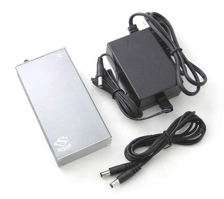

I just bought a set (2) of those 12v Lithium batteries (see below) to power an external monitor for my XL2 and some onboard LED lights hack, (altogether about 3Ah). However, while doing my research after the fact of buying them, I now discover that there's an "unique drawback of Li-ion batteries since the service life dependents upon aging (shelf life)".
So I'd like to know if I need to get some NiMH (or whatever) as a backup or replacement.
Any advice or enlightenment appreciated.
-- peer

There are Lithium Iron Phosphate batteries that don't have these issues. Search for LiFePO4 and there should be some in 12v capacity. Lithium Manganese are also good Lithium variants but aren't quite as common in plain battery packs (they are used in tools frequently). NiMH batteries won't last as long as regular lithium so don't bother with that route.

The Li-Ion batteries age naturally at about 10%/year, which is not that bad comparing to the other chemistries. Depending on the cell quality and internal safety electronics, they can fail sooner and unexpectedly, so pay attention to the warranty, and save your receipt ;-)
