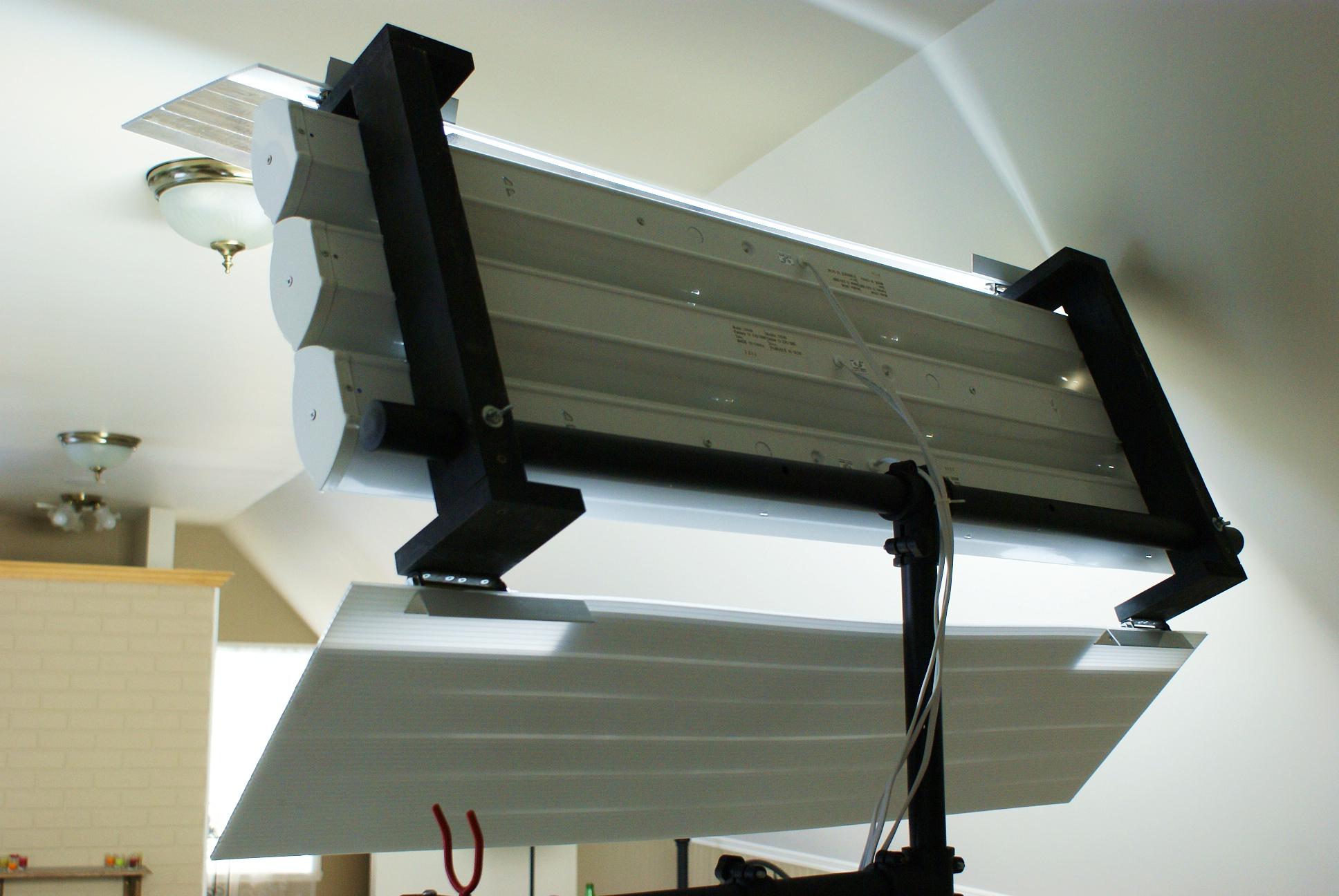

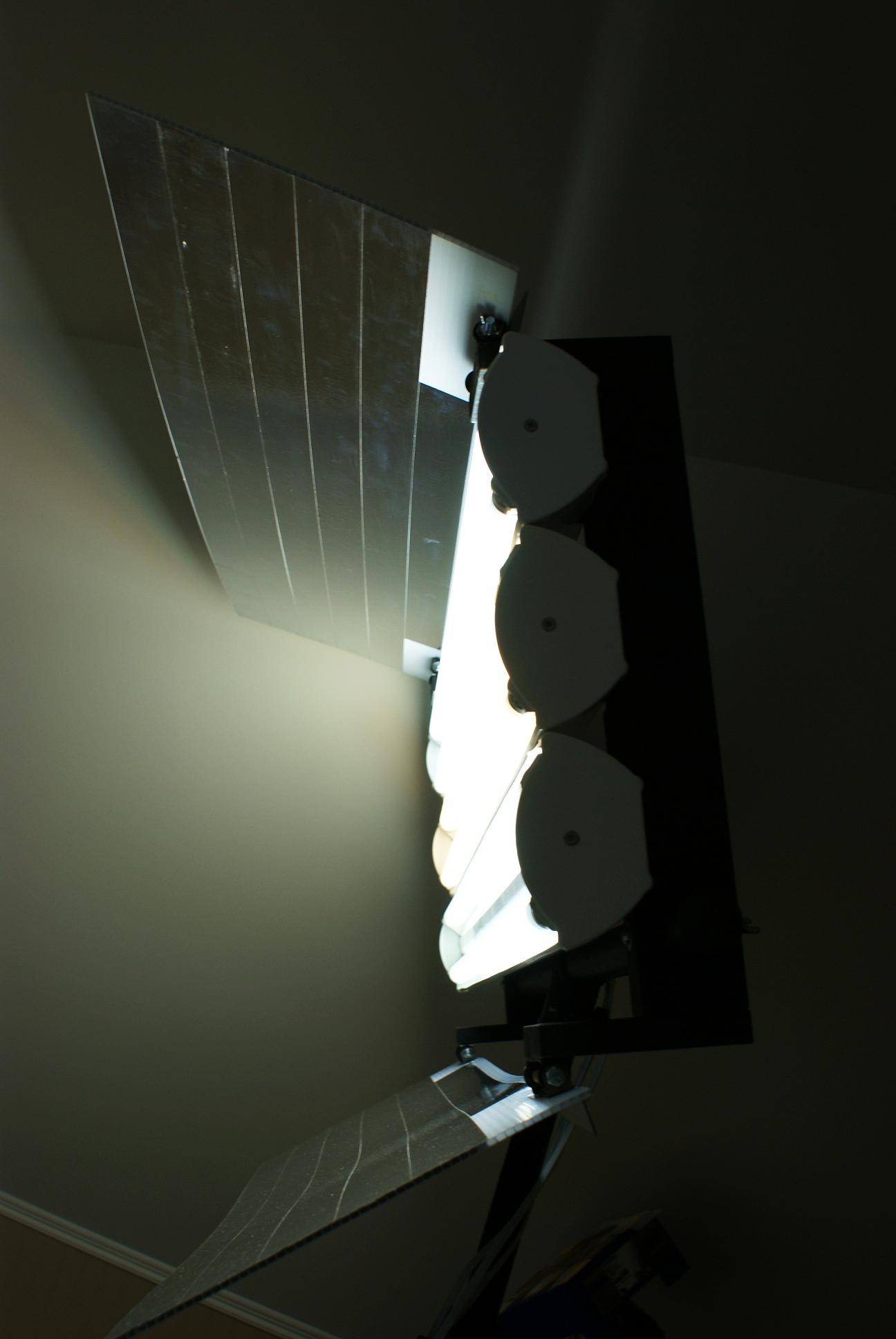

Hi everyone,
I built a home made lighting kit (see JPGs) I used 3 basic lighting fixtures, they each have 2 48" T8 fluorescent tubes. Basically they're sold to be used in garages (I know I'm not the first one to do this) I have 6-6500K tubes for cold type lighting and 6-3200K tubes for wharm also.
So here's the situation;
From rescent tests I made the cold lighting makes the skin look yellowish, I want to have that regular pink skin look, even in post production with the color correction I'm having a hard time getting it. With the warm lighting tubes the skin turns out ok yet you can still notice a bit of yellow in there.
I have a camera F-DL filter which I tought would fix my problem but it dosent seem to change much, I tested the warm and cold White balance on my camera and can't seem to find the right settings or combination of all this.
Thanks in advance!
Fluorescent vs skin tone-dsc00593-.jpg   Fluorescent vs skin tone-dsc00595-.jpg

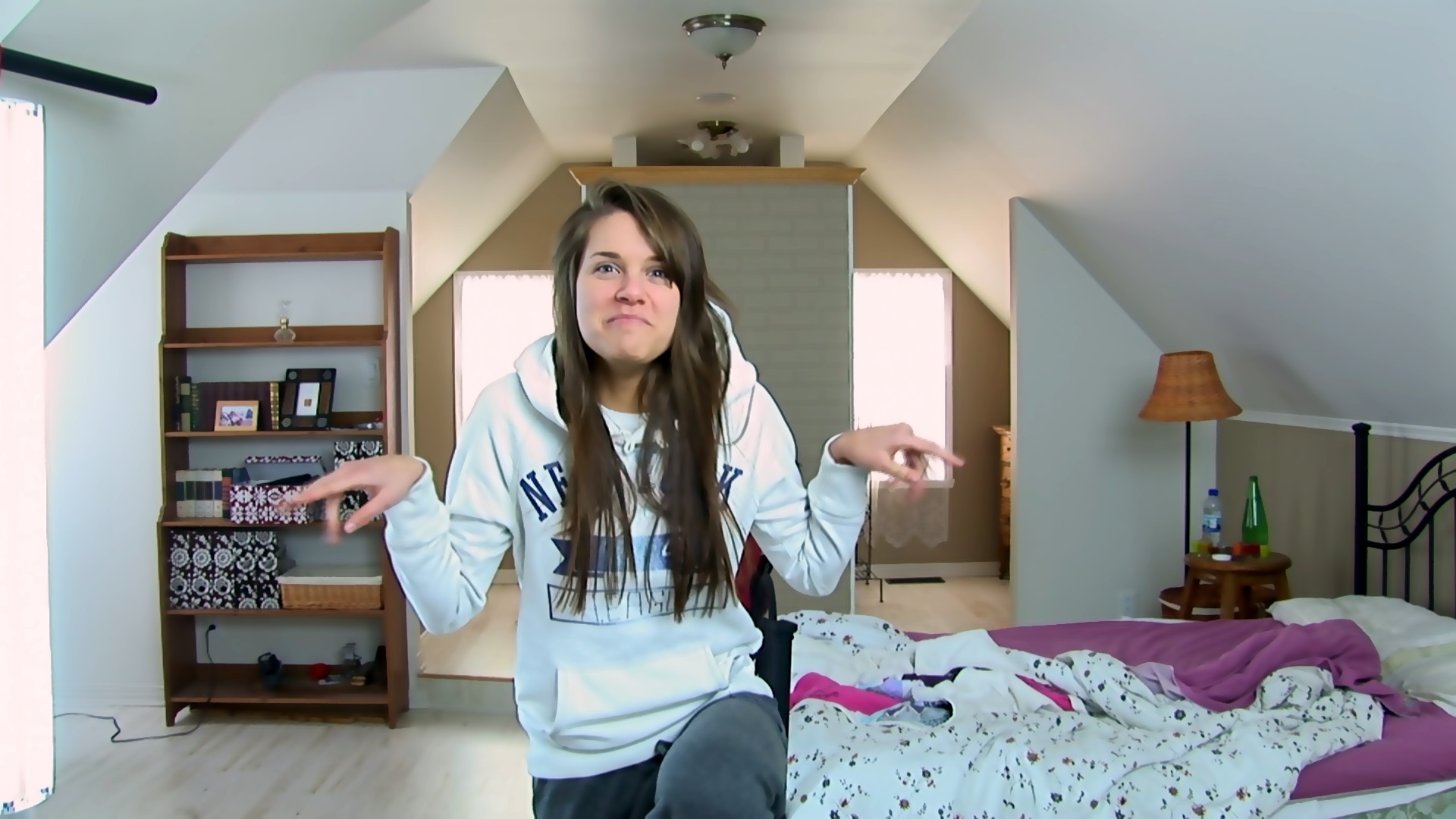

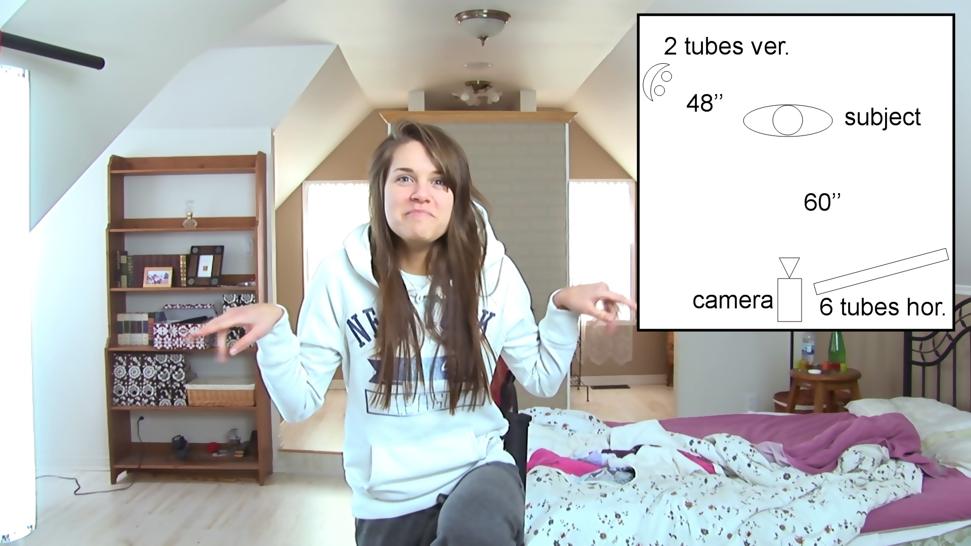

Ok I managed to get the CRI info and it's at 78.
Take a look at my JPG (taken from post-production) and here's all my setings, tell me if you see something wrong ;
LIGHTING :
6 - T8 48" 6500K 78CRI tubes, horizontal with reflectors right next to the camera (60" from subject)
2 - T8 48" 6500K 78CRI tubes, vertical on the back side of the subject.
CAMERA (HDR-FX1) :
0 gain
F3.1 Iris
60 Shutter Speed
White balance set with a white piece of paper at the subjects exact location
POST-PRODUCTION (vegas) :
+0,15 contrast added
+1,20 saturation added
+0,05 red added (midtones, color balance)
+noise reduction (smart smoother)
Ok forget about the background, would this be acceptable for a information video where the subject talks about a product or a company? thanks in advance!

Old January 26th, 2009, 11:27 AM   #6
Location: Tallahassee, FL
Posts: 4,100
It's hard to judge the colors because half the frame is clipped.
CRI of 78 is a bit dicey to me. I'd feel a bit uncomfortable working below 85.
Old January 26th, 2009, 12:04 PM   #7
Location: Montreal, Canada
Posts: 142
Sorry Perrone I should've specifyed that the JPG you saw was just a test and the final product will be in front of a green screen, So never mind the surrounding color what I'm looking for is the Skintone color.
I tought the skintone was a little pale, so I did another one and added saturation (1,30) and took out brightness (-0,10) see my new JPG
For the CRI issue, I'll be on the look out for higher CRI tubes, but for the moment that's what I have.

Old January 26th, 2009, 02:50 PM   #10
Join Date: Oct 2004
Location: NYC
Posts: 260
the image has a blue/green cast - I would guess partly due to low CRI and partly incorrect white balance.
You cannot accurately determine WB for a 3 dimensional object by measuring the reflection from a piece of card - use a monitor or plug the cam into a laptop and use the scopes in the NLE.
Doug Bennett is offline   Reply With Quote

Old January 26th, 2009, 03:47 PM   #14
Location: New York
Posts: 204
So the only problem is that you think she's a bit pale? Is she pale in real life? Perhaps all you need is a little warmth, like an 1/8 cto or even a cosmetic pink on the flo (WB first without the gel).
From a quick look on a regular computer monitor, I don't really see a problem with her skin tone. It looks pale, sure, but not unnatural. If the paleness is the only problem, all you really need is what I mentioned above.
Good luck.

Old January 26th, 2009, 04:05 PM   #15
Posts: 142
Actually the original problem (if you read the very first post) was yellow skintone with the fluorescent lighting.
And she's actually tanned in real life.
I'm having a hard time finding the right settings or should I say the right mix (lighting/camera/post-prod), I'm doing a lot of testing and I can't seem to get that winning combination. Ok I don't have the yellow skintone anymore but I don't have her real skintone either.
Can overlighting the subject ruin everything in post-production? my Iris was open at 3.1 maybe I should've closed it a bit more?
