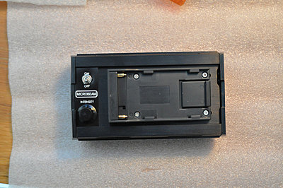

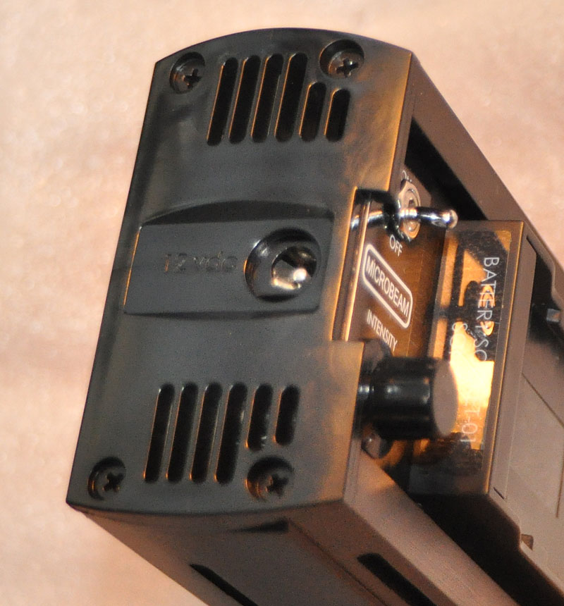

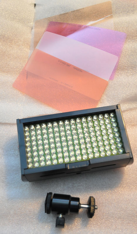

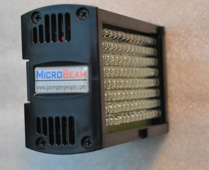

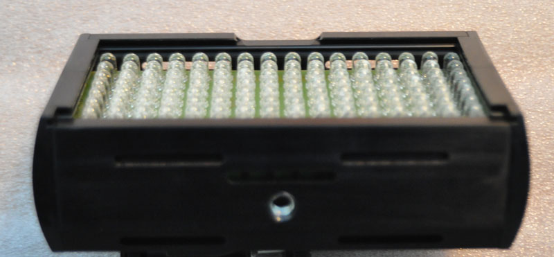

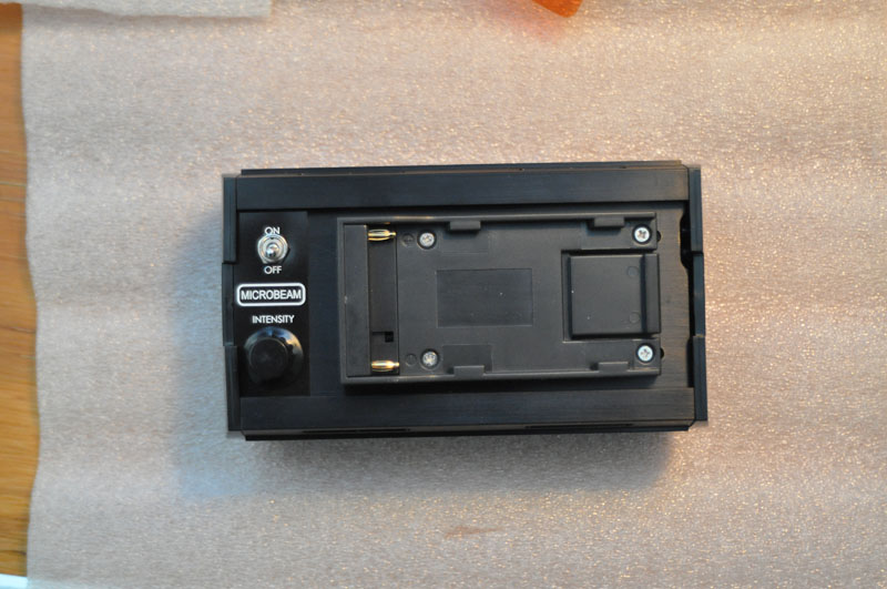

These photos must have been prototypes. I just received one I purchased, the photos are below:
Microbeam early impressions-microbeam1.jpg   Microbeam early impressions-microbeam2.jpg
Microbeam early impressions-microbeam3.jpg   Microbeam early impressions-microbeam4.jpg

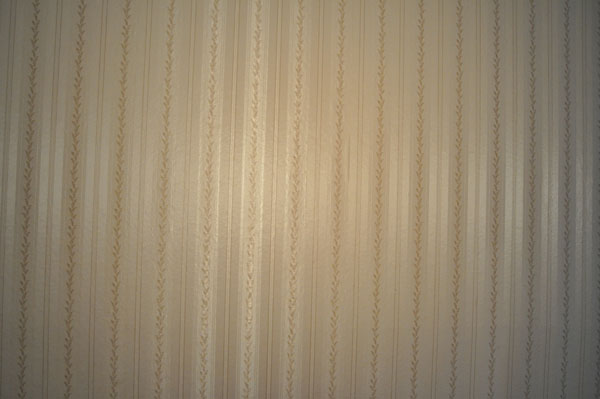

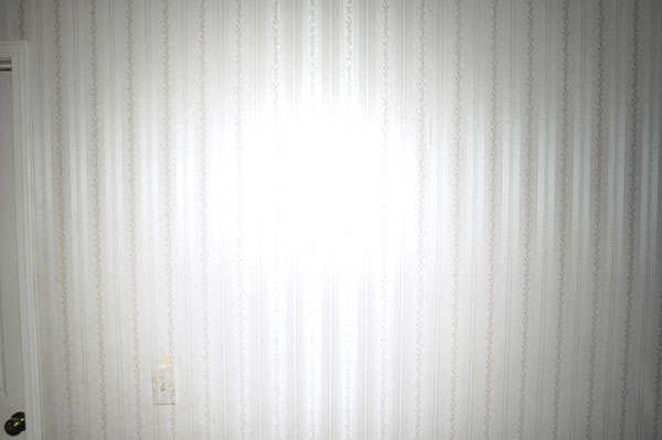

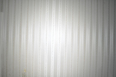

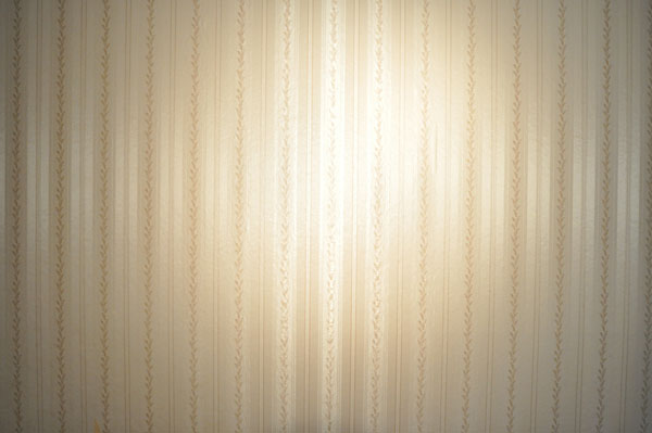

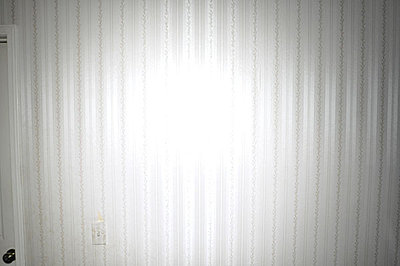

Next I did a quick comparison between the Sony HVL-20DW2 20 watt incandescent light vs. the MicroBeam. The photos are not color corrected and were taken with my Nikon D90 in Auto white balance, manual 1/60, F3.5, ISO 1600, 17mm lense (26mm equal) about 10 foot away.
The MicroBeam was turned all the way up and shows un-filtered and with the included diffusion. The Sony had both 10 watt lights on showing no diffusion and with the StoFen diffuser. My goal here was to look at patterns/spread/hot spots.
The MicroBeam had much higher output than the Sony. The Sony had a real bad hot spot with no diffusion. The Microbeam was so much hotter without diffusion that the photo clipped in the center. This might be good as a spot light at some distance. The spread was barely acceptable with the included diffusion on the MicroBeam. With as much power this puts out, I will be using more diffusion.
The only other comments I have is the dimmer knob is attached to the potentiometer just barely tight enough. When you get to either stop, high or low, the knob keeps turning. You can pull the knob off with little effort. Not a biggie, a little superglue will fix it.

Just keep in mind, according to your specs, you were shooting at ISO 1600. That is WAY more sensitive than most of these camcorders.
Also, regarding those pics of the blue light, the light can be ordered in either blue or black. Or it could when I made my phone order. I ordered black cause, who wants a blue light?
The diffusion that comes with the 'Beam does not look that heavy. A piece of 216 or 250 would probably do the trick.

I was not referring to the color in the other photos. Next to the switch is a gaping hole and the knob looks to be aluminum.
I aggree that I could have run a much lower ISO but I was looking for the pattern. I also agree that more diffusion is very easy.
