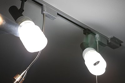

I know that this is an old thread but I seemed to have fallen off the Earth for a bit. I wanted to ask about using the Lowel X1-65 65 Watt/120 Volt bulbs. These screw into standard household sockets correct? If so I'm not sure which kind of lamps you were thinking that I should use. I want to do this as cheaply as possible and if I can get by with a few standard desk lamps then sure, I'd do that.
The Lowel X1-65 fluorescents screw right into a standard household lamp socket. Just make sure the light fixture can handle 65 watts. I use these in our studio along with some track lighting.

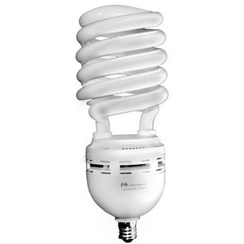

Lowel should be coming out with an 85w version soon. They would be out by now, but the recent shipment didn't meet the specs. The 65watt version has a CRI of over 91 and is color accurate - no weird green, magenta, or blue tinge.
Get some cinefoil (aka blackwrap), it's like a black aluminum foil if you're not familiar with it, and you can build your own barn doors and flags so you can shape and block the light.
Lowel lamps - DVcreator Kit Bulbs at DVcreators.net
Hope this helps,
