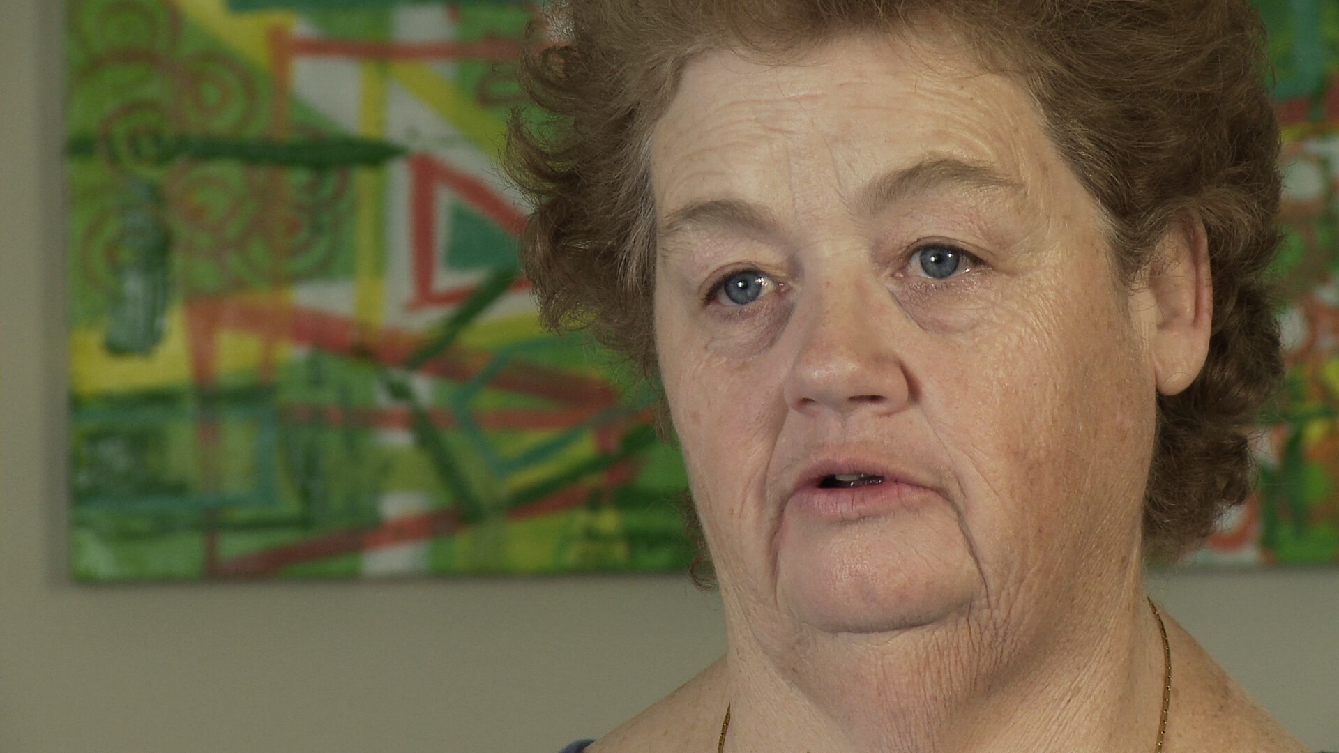

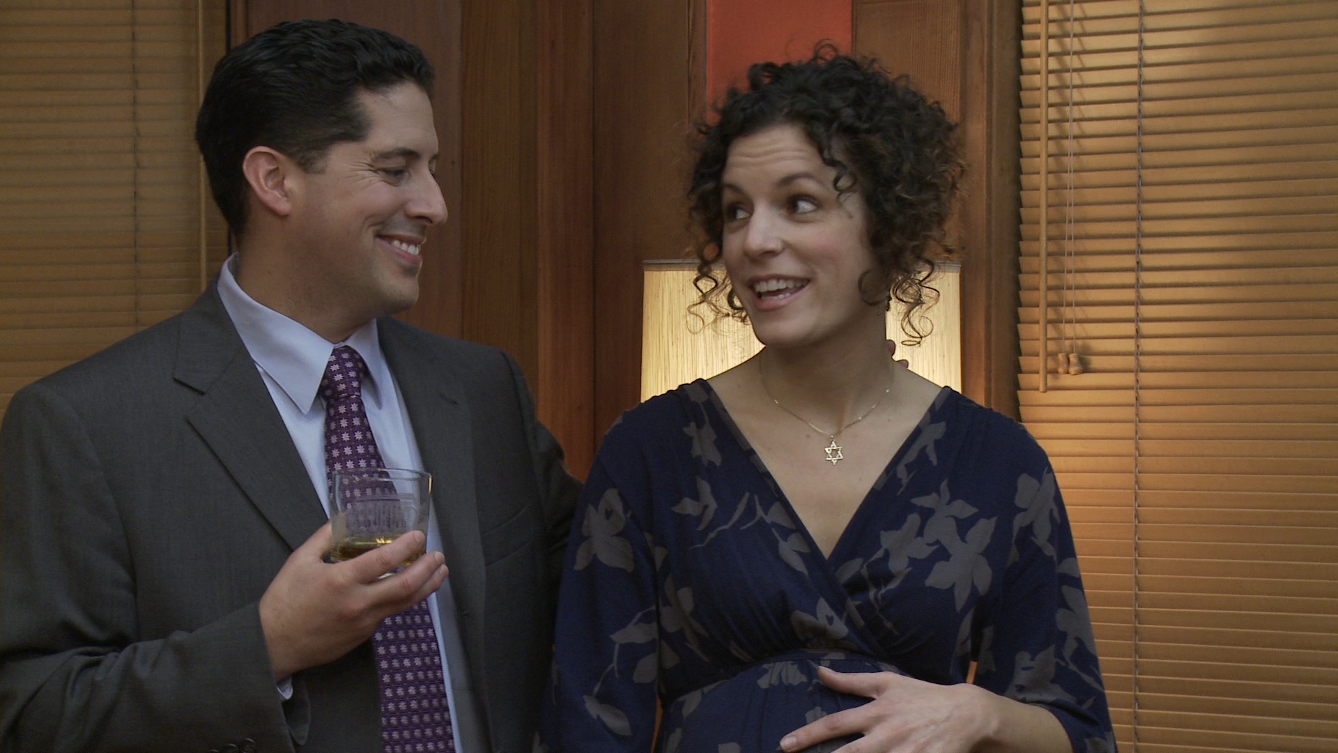

My light kit currently consist of only hard lights. I shoot a combination of movies, documentaries and some interviews. I've got 4 CDM 150's and one CDM 70, two soft boxes for the 150's, assorted scrims and cutters. I'm probably going to eventually get an LED light but for now I definitely need the ability to control the light a little more and when I need them, the soft boxes do a great job.
Here are a couple of screen grabs from two different applications with basically the same lights. The first one was with two CDM150's both with soft boxes and one CDM70 as a back light. The second pic is on location in a house with a lot of dark wood that just sucked up the light. We used 4 CDM150's and assorted reflectors. The practicals were almost impossible to control but we needed them on for effect.

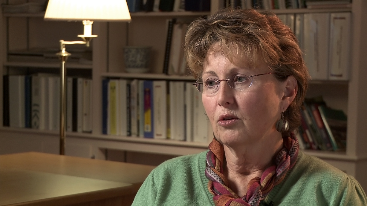

I feel whatever fits in the room and fits in your budget makes up the ideal light kit. I shot this interview in a 12x14 room with a total of 2 lights - one 250 softbox with a 40 degree egg crate (key) and one 250 spot (backlight) with barn doors. I used a 32 inch reflector as a fill and one practical was used to light the background. It took less than an hour and a half to set up, shoot the interview and tear down. The cost of the lighting kit was minimal and I only had to make on trip to the car. I think being able to control the light you do have is the key issue.

Garrett - thanks for the pictures. I have a couple of Richard's 650 fresnels that I like quite a bit but except for BG with cookies or color, I might not be using them quite as much with my cooler light components... I'm assuming that the CDM 150s' power isn't equivalent to a 650 or something like that - but like a flo you can't entirely use the wattage as an indicator of the power of the light output - any thoughts as to how you'd rate the light compared to something like a 650W tungsten?

Bob - I totally agree with you. I'm not a lighting expert per se, but I'm learning that each has its place, and that guys that really know how to do it can do with one or two lights what would take me 3-4 or more. With the kit I have now I think I can shoot most one-up interviews and might be able to get away with a two-up if I had the time. I need to get to the point you are with speed, though - 1.5 hours is impressive. :)
