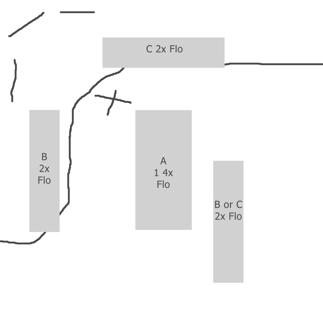

It sounds like I should replace the ceiling fan with a 4x or a 2x fluorescent fixture with a diffuser.
My main question was to have have the fixture be straight above where I sit as to have the light coming straight down or have the fixture in the middle of the room.
Middle would be easier as the wiring is already there and the distance is only 2-3 feet over.
I have attached a crude overhead scetch of the space with some sample light positions.

If it was me, I wouldn't put anything on the ceiling that would end up behind my back while I was working. You're more likely to see some glare in that way on the screen. Not that it will absolutely happen but is more likely I would think. Straight overhead seems like more the ticket.

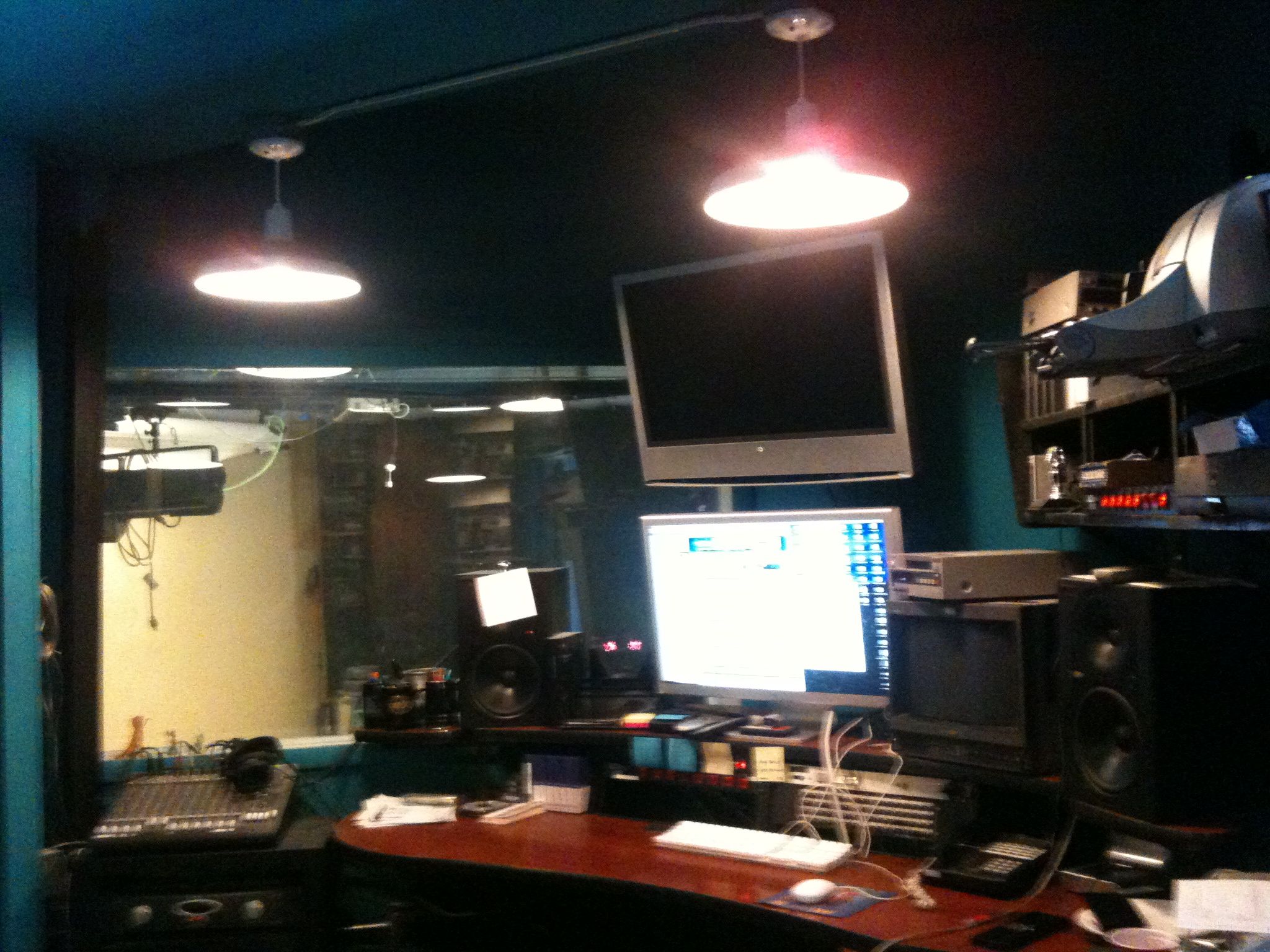

In my studio, I considered a lot of options but in the end I figured that I wanted light that would be relatively soft, concentrated on the desktop and not spill much on the computer screen.
I ended up using the CHEAPEST fixtures in my local Home Depot - which happened to be 14" round industrial shades on a simple socket and cord. I think I paid $9.95 each for them. I have 4 in the edit suite. 2 suspended over the client couch. And 2 suspended over the center of my edit table. I use 40 watt "vanity bulbs" the large 4" diameter soft lights for use in bathrooms.
To my taste, the light is PERFECT. Enough to light up my worktop for writing, etc. but hardly any light up or on the walls surrounding.
Here's a fast iPhone snap. The lamps are overexposed, obviously - but the point is that they're cheap, nothing special fixtures and they work great.
YMMV.
