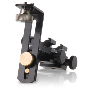

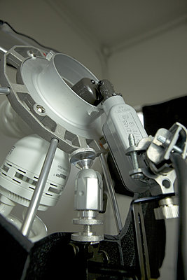

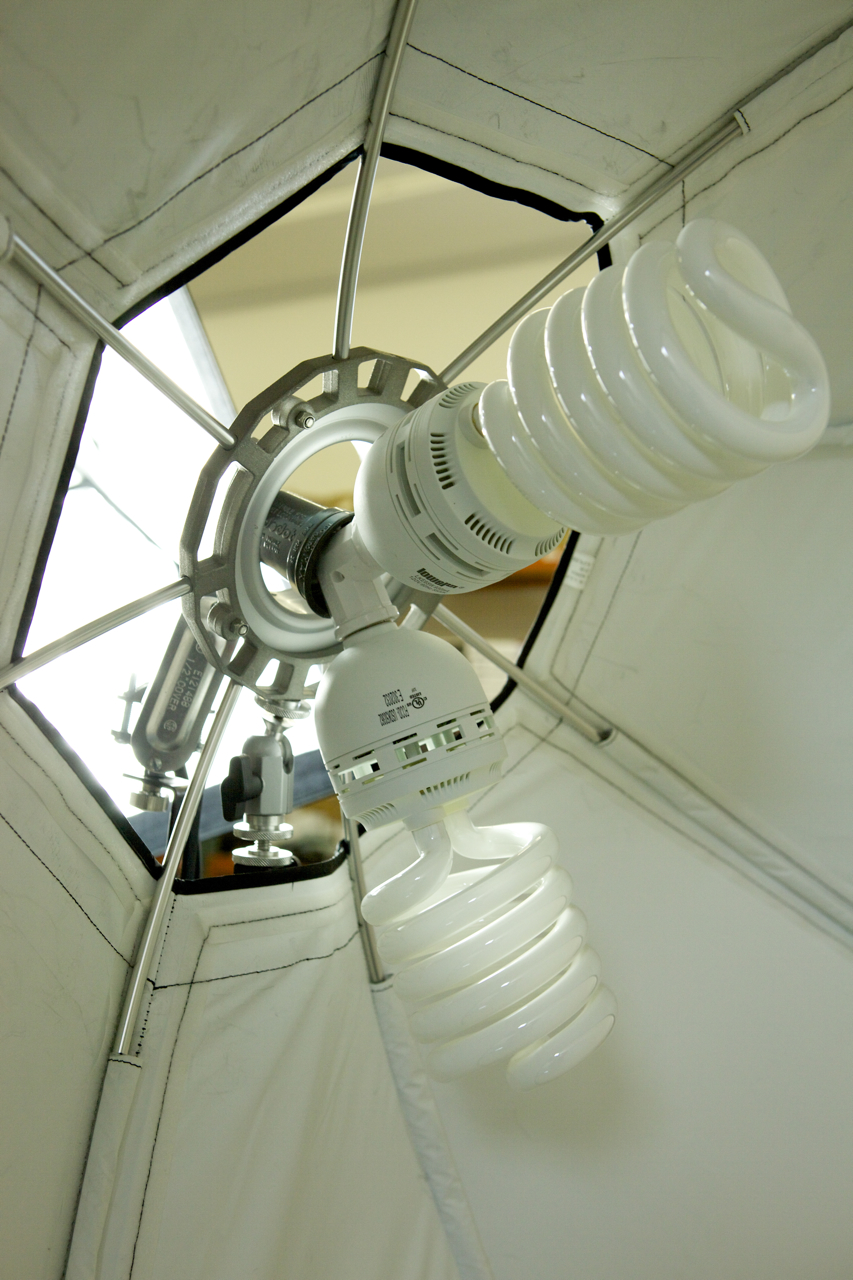

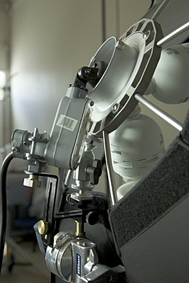

I had the same question a few months ago and thought...hmm maybe I can put together something out of Home Depot parts and some Lowel 65watt fluorescents. Initially this was supposed to be for the Medium sized Photoflex Octa, but I wound up needing it with the Large. It's definitely sketchy with a softbox that large.
Here is what I came up with. With the 5' Octa, this set-up actually produces an amazing quality of head to toe light. If I remember correctly, I spent less than $50 at Home depot to make two of these. The fixture is actually for a porch light and the L connector is for joining conduit.
The Photoflex Adjustable Shoe Mount Hardware is $39.95. That's the black metal mount which allows you to position the fixture up and down. Kinda ghetto, but it gets the job done. Again, I would not recommend this set-up with the large, but with medium or small soft boxes it can get you by.
