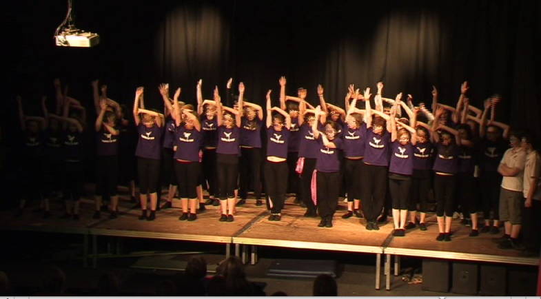

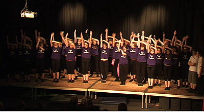

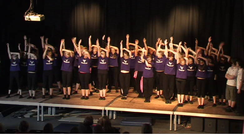

Here's a couple of screen grabs off the DVD (this show went straight to a Philips HDD DVD recorder). No outbreak of flesh-eating superbug - faces have been smudged on these pics to avoid individuals being identified.
When the photographer fires his flash another 3 almost unlit dancers appear. This happened several times during the show.

From Pic#2 it looks like you shot this in 50i? In a low light situation like this I'd shoot 24p (or in your case 25p). That way you could set the shutter at 1/50th and pick up a little more light? What were your settings other than the gain?

Guilty - 50i it was. With hindsight, I would have got more light on 25p as you say, but when I was setting this up, I didn't realise it would be so dark during the performance. I had the lights turned up more during the run through and decided that 1/50 sec and 50i would be the best compromise to catch the movement and still have enough light. I didn't fancy changing the frame rate once the show had started and I saw what I was up against.
I switched off the custom presets as I didn't have one loaded for filming black cats at midnight. In future I'll keep one ready - which do you think would be best for this kind of situation? I don't like to take the gain beyond +6dB and try to keep it at -3 or 0 if possible.

The central faces are correctly exposed, getting more exposure on the camera so you could see into the darker stage areas would mean that these faces are over exposed. The still camera's flash just added some fill light, so you saw more detail in the shadow areas.
25p is normally 1/50 of a second unless you select a slower shutter speed.

As I started thinking about it, it did dawn on me the Colin probably had his shutter already set to 1/50th. Out here in NTSC land we get a little lighting advantage going from 1/60th to 1/48th for 24p.
I agree that overall the exposure on the middle of the stage looks ok. That is always one of the biggest issues with live performances,there's just a lot of hot spots on the stage a a lot of dark areas.
Really the only way to combat this is to get a couple more cameras and get them closer to the stage on the sides to get the exposure correct and frame for the darker areas.
Colin, I did have a preset that I worked up that helped with stage shows. I'll have to see if i saved it somewhere. I no longer use Canon cams so I'll have to dig through some old files. The other way to help out is to get a camera with a bigger sensor that can pick up low light areas better. Then you could stretch the blacks to retain some more details.
Fair enough, but when I had the lighting turned up there was much more spill, and so less contrast between the centre stage and the darker areas. With the greater illumination level, I had the lens stopped down a bit, so the faces were still OK (my zebras were grazing peacefully).

Unfortunately, I suspect the contrast ratio would remain the same, just the light levels were higher in the shadow area. So, once you set the correct exposure, the stage wings would still be dark compared to the still brighter centre stage.
