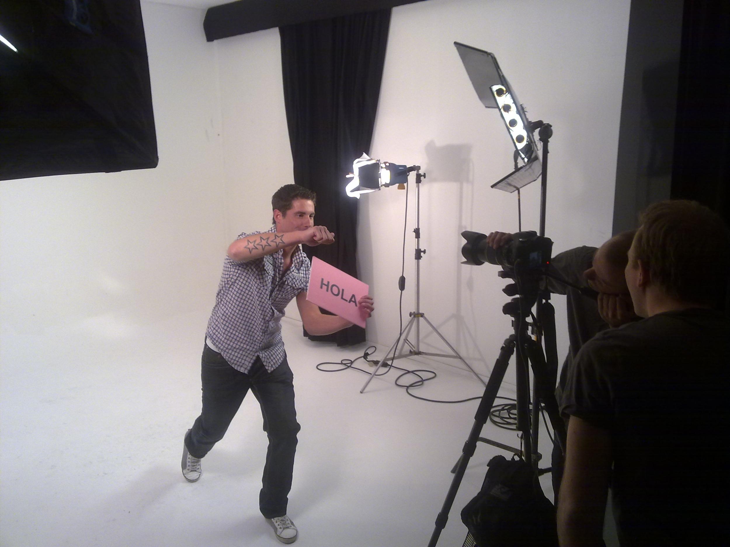

Thanks.. attached is a pic the director sent from the last shoot they did there.. I dont really see anywhere above where you could put a wooden frame rigged with different lights behind, if i understood you correctly?
Maybe China Lanterns taped to the ceiling? Not sure if the studio would be too happy about taping stuff to their clean white paint job though..
Just to get back to basics though, when you want to evenly light a larger area you'd need something like flourescent lighting? Is it also possible to use redheads or fresnels with diffussion? Softboxes? How would you then handle backlighting? Or would this be impossible considering the larger area and not having lights in the frame (I think the subjects will be shot entering an empty white set from left and right and shot in full profile)

Based upon your picture, you don't have a stage, you have a small, white room with a low ceiling and no grid. So forget space lights and China balls, your ceiling is too low, even if you set up polecats or cross bars. Forget suspending an 8x8 or 12x12, you don't have nearly enough room.
You look like you are stuck with lighting from the floor with either fluoros or Chimeras. Simple. That's all you have vertical room for.
It's tough to do a studio type shoot when you don't have a studio.
Dan
Old May 3rd, 2010, 02:06 AM   #11
Location: Belfast, UK
Posts: 6,160
Yes, nothing big.
Perhaps, the only real top light could be bounce off the white ceiling, 2k blondes are pretty good at that, although the heat can build up if they're left on for too long.

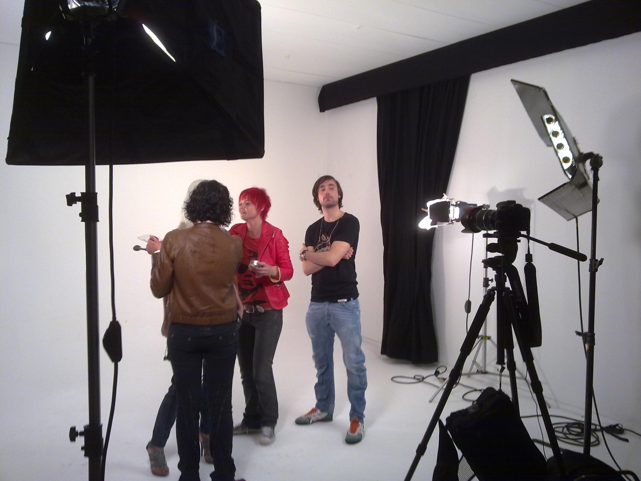

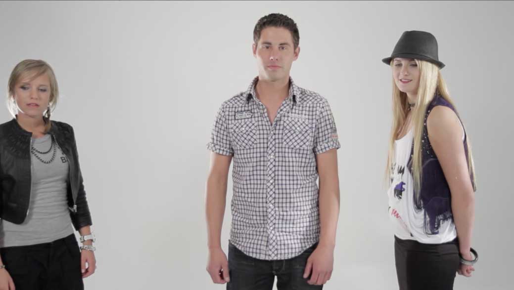

sorry i didnt update.. it went pretty well, actually i had completely the wrong idea about the shoot, there were about 30 actors but not on screen at the same time! there were one or 2, max 3 at a time, but dancing around so the frame and space that needed to be lit was about 3x2, much smaller than i thought.. in the end we used 1 kinoflo and 4 fresnels.. kinoflo for fill, fresnel with softbox for key, one fresnel to light the back wall and 2 as backlight.. the backlighting could have used more coverage and i thought it was a bit too soft in the face but the director wanted it that way.. any suggestions for improvements welcome!
