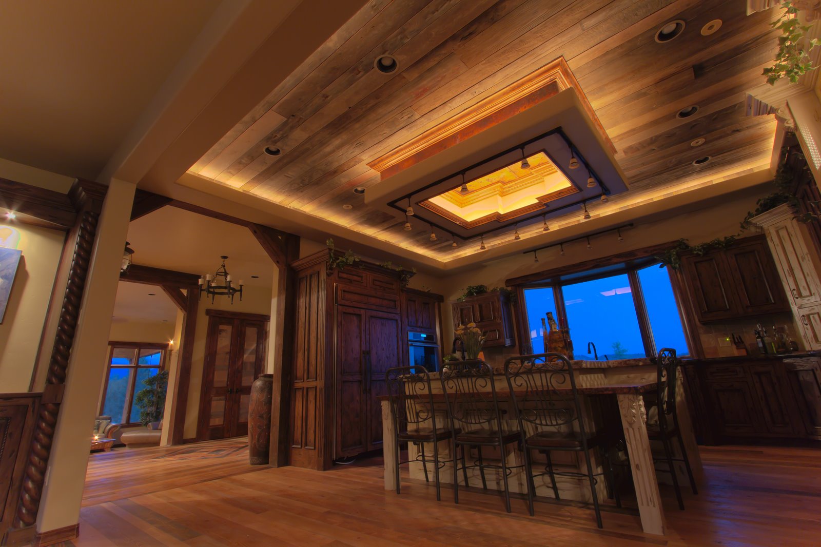

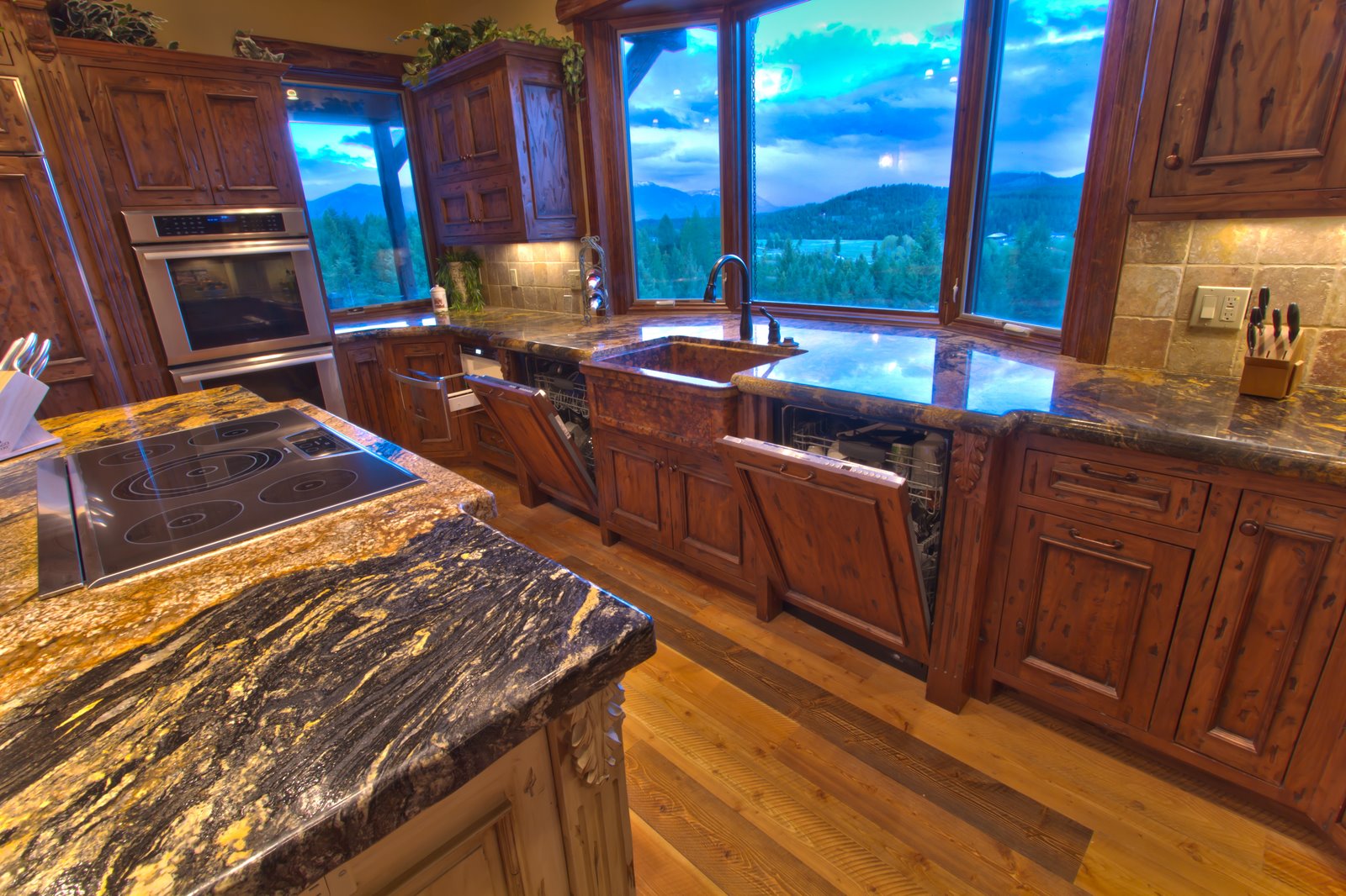

I'm going to be filming a series for a cooking school in a cool lodge style house with an incredible kitchen. That's the good part. The bad part is there are three big windows (bay window) directly behind the main cooktop area where most of the action would be happening. There's also a window off to one side.
The producers want to keep the awesome mountain views in the shot as my HDR pics I took below show. HDR in Photoshop is one thing (taking multiple exposures and piecing the right parts together so everything is exposed well), but in video I'm having a bit more of a challenge.
What would be the best and most cost effective way of handling this? Is there some sort of ND plastic that can be applied to the windows so everything's not blown out? Although this is an ongoing program, it is still a house that is in use most of the time so it either needs to be removable or nonobtrusive. I see windows all the time on news programs, but I've never had to do a setup like this before that is going to be an ongoing production.

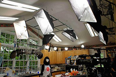

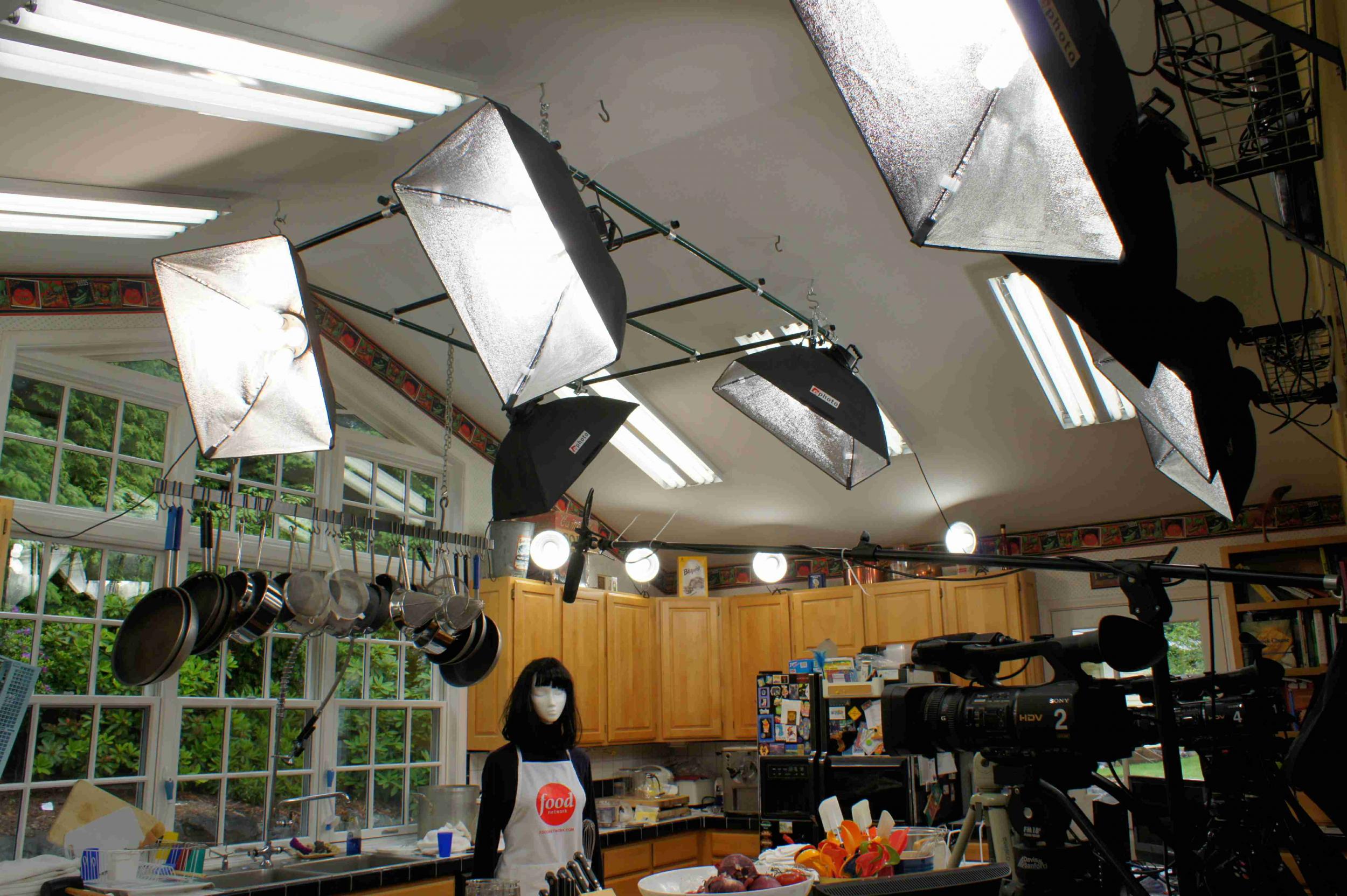

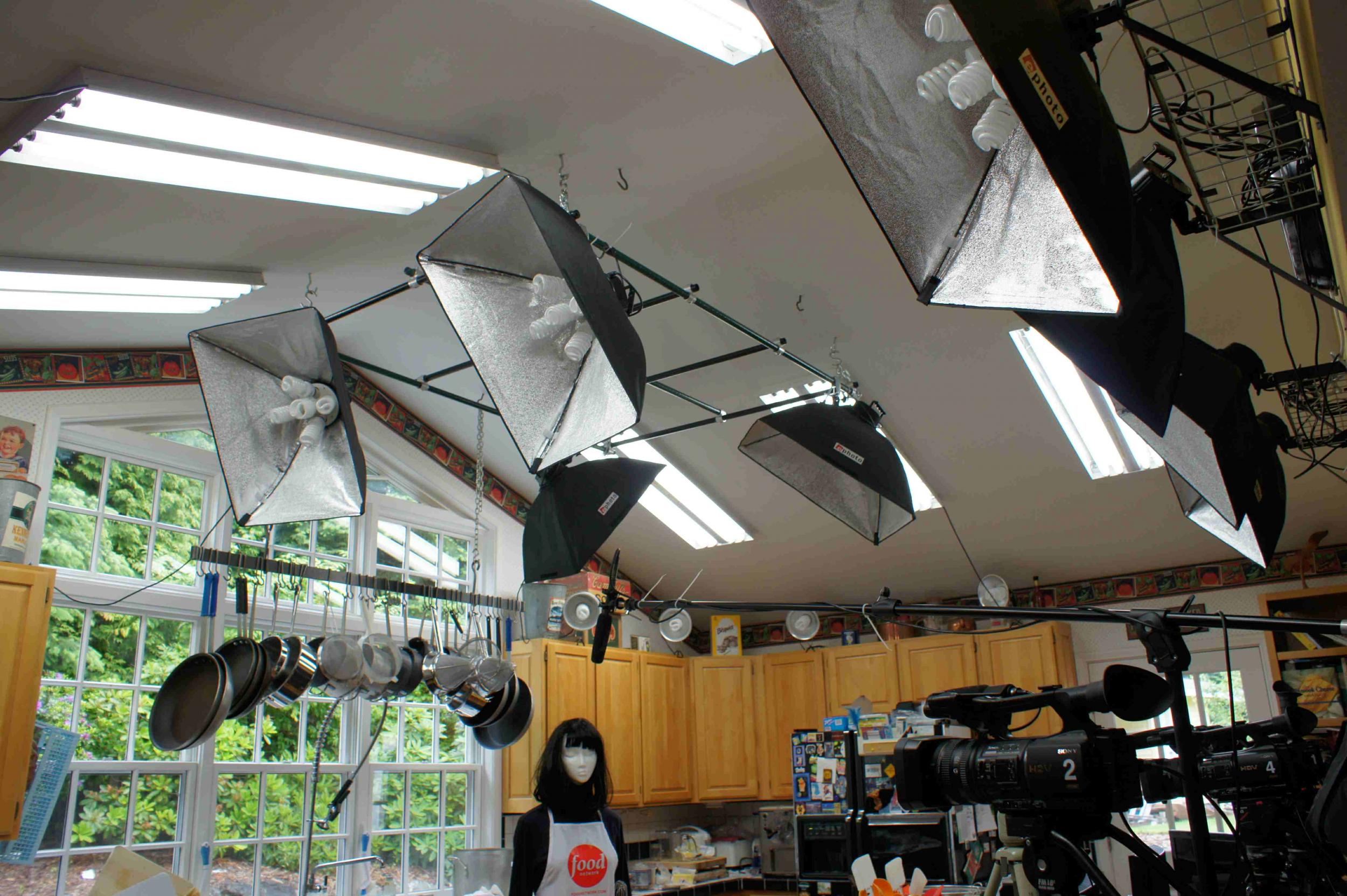

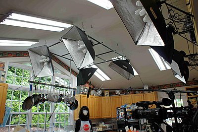

Here are a couple of quick snaps, one with just the existing fluoros on, and one with the extra lighting fired up. The windows are not yet gelled and we used to have some nice fake plants just outside the windows, but it's raining at the moment so we had to take them in.
I was thinking about doing a more detailed write up of our build with more photos; if there's any interest I will.
Hope this helps.

Wow, Adam! I can't thank you enough! That is very helpful. I especially like the lighting setup. I never thought of clipping lights the cabinets. Very nice.
And YES YES, there is A LOT of interest in a detailed write up on this; at least from me! :)
I might take some pictures of mine as well and do a write up as well.
