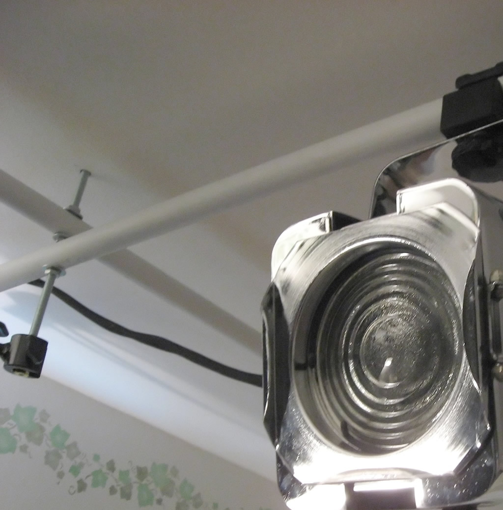

When I went thru this, I found that stands in small rooms get in the way really fast. Ditto the cords.
I poked four 3/8 threaded rods thru the ceiling making a square about 20" in from the walls. In the attic, I attached them to rails that span the rafters. With the rods sticking into the room about a foot, I drilled holes in 1 1/2 Galvanized conduit. Let the conduit go another 12" past the junction. Now you have lots of places to hang lights. Very adjustable. See attached photo. eBay is your friend for getting a good deal on some incandescents like Lowel Omni or Pro. Someday, you'll want a softbox like a Rifa or similar.

+ 1!!
