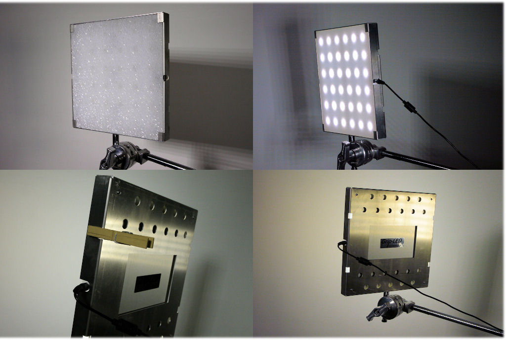

Just thought I would bring everyone up-to-date on the status of my Grip-LED light, including a picture of the light. It seems that the led panel is not available at LEDwholesalers. And, no one knows for sure when LED Wholesalers will have the panel in stock! I wold love to find out who is the actual manufacturer of this led panel... a company in India or China, no doubt... so I can buy directly from the manufacturer. As you know, the Litepanel company is now selling it's H2 light... the H standing for high power and the 2 for 2 panels (I'm guessing here)... their light has 72 1-watt led's and is 1' x 2'. So Litepanels is basically using 2 36 led panels in a frame... not sure if they are using the exact panel that LED Wholesalers was selling... but could perhaps explain why the panel is not available from LED Wholesalers! Also, the Litepanel H2 light is selling for over $4000, which is way over priced for the indie filmmaker. I was selling my Grip-LED light for $249... 2 of these lights for $500 would equal the light output of the $4000 H2! Here is a picture of my light.

Dave: I hear you and absolutely believe thae LitePanels has done exacty that: taken two of the $150 panels that LEDWHOLESALERs was selling and slapped them in a frame and is attempting ripoff the indie market with a 1,333% price increase.
I actually won three of the panels from LEDWH's ebay auction in February. They never shipped them, refunded my money, and explained that they sold out their stock due to foot traffic (which at the time was 47 units). So, their warehouse south of SFO airport gets a lot of foot traffic. Uhhh, yeah, right.
A month ago I called them and they said that they were looking to find an alternative but had no luck and no leads.
It is my strong suspician that, either Litepanels bought out that stock so that it would not compete, or that Litepanels created an exclusive supply contract with the Chinese manufacturer/distributor (or both).
Its a sad situation. I hope that you find a replacment panel. I was about to publish an article about a DIY Creamsource for under $800 based on these panels.

Michael, amazing, isn't it? I'm kind of befuddled with this whole situation. I have sold all of the Grip-LED's I made... 20 so far... I still have 2 of the prototypes that I am using in my own lighting kit. I just bought 2 36-led lights from www.thecinecity.com (India). I did this just to see what kind of panel they used and to add to my lighting inventory. It is similar to the one that LED Wholesalers was selling. But, it is not the same! However, I thought that I got a pretty good deal... the 2 lights cost $550 (+ $175 shipping from India) and I also got 2 light stands, a double header, so you can put both lights on one stand, and each light comes in a case along with diffusion sheets and color correction sheets for tungsten balance. The lights are 5500K and are about 1/2 stop brighter than the panel that LED Wholesalers sold. I am still looking and would like to find who the manufacturer is and deal directly with him.
