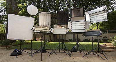

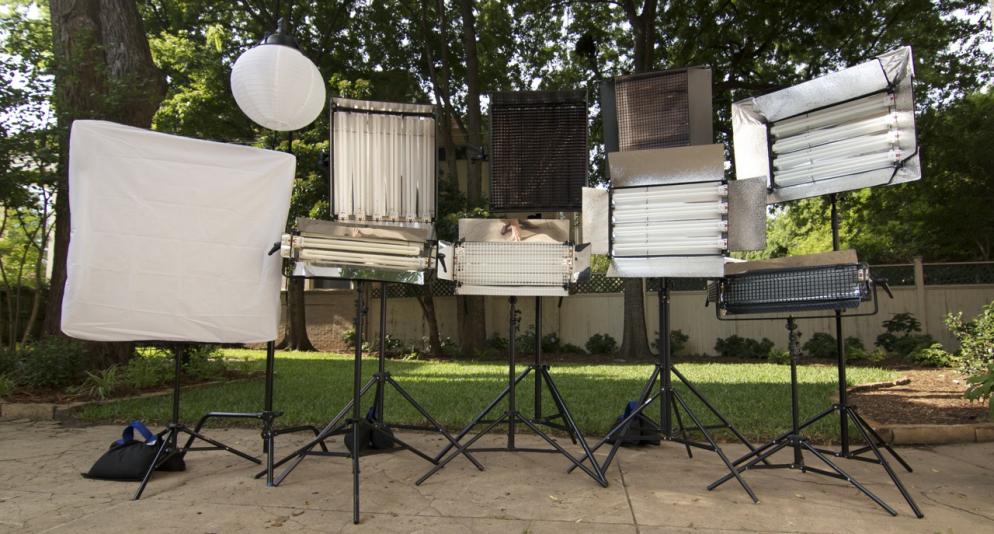

There are tons of inexpensive flo lights out there which can be used to supplement tungsten and HMI lights.
Here are a few of my flo lights.
