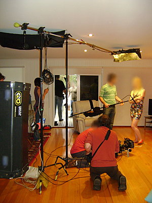

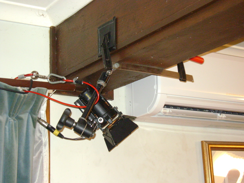

hi bruce,
manfrotto make polecats in varying sizes which would probably work in this instance. make sure you mount them over a stud behind the wall.
i use a stud finder to locate them
couldnt find any pictures but found some of other ways i have got around
this problem.
cheers
