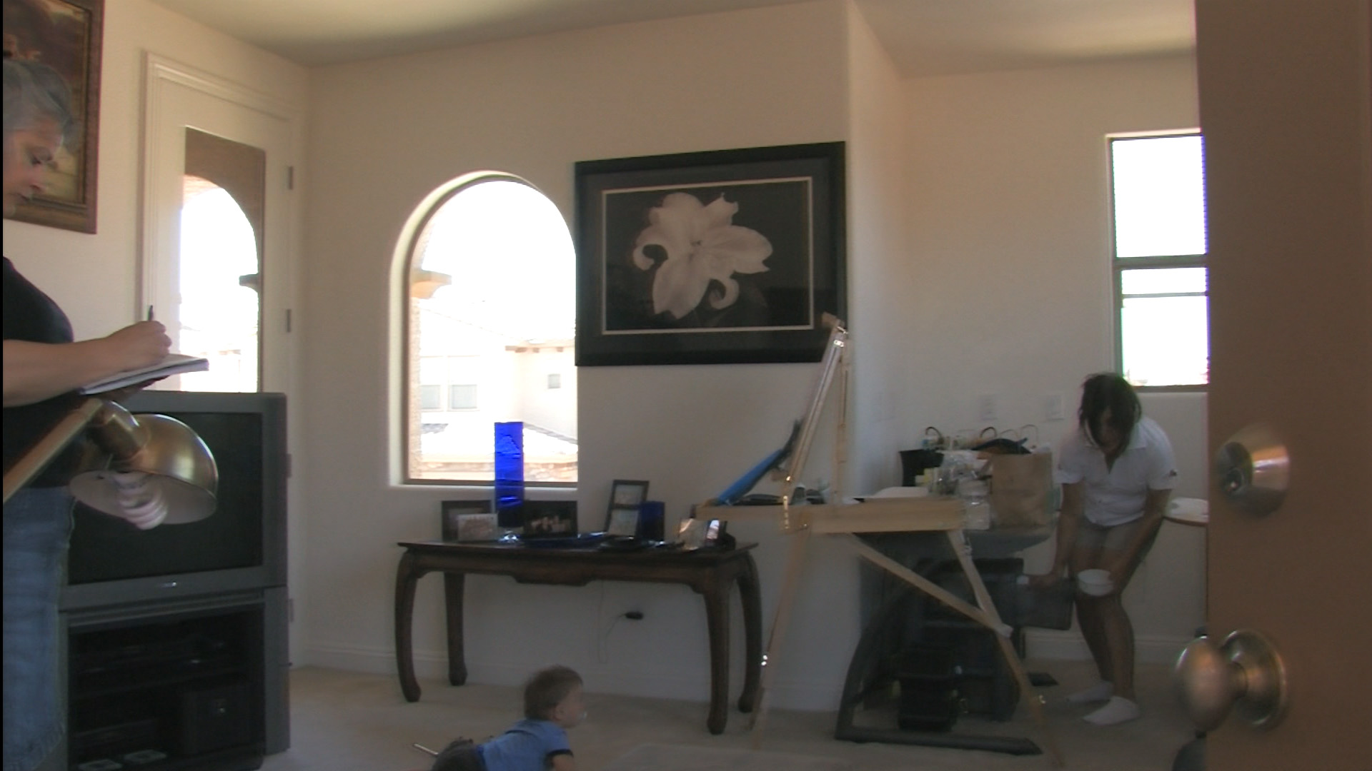

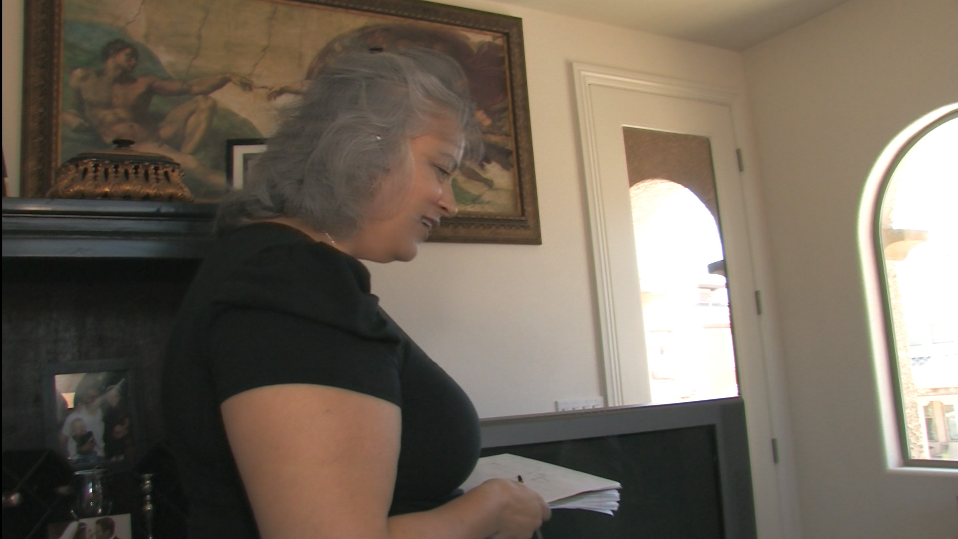

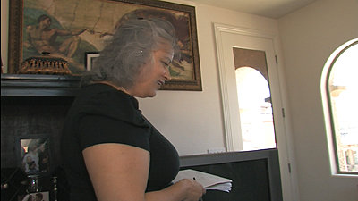

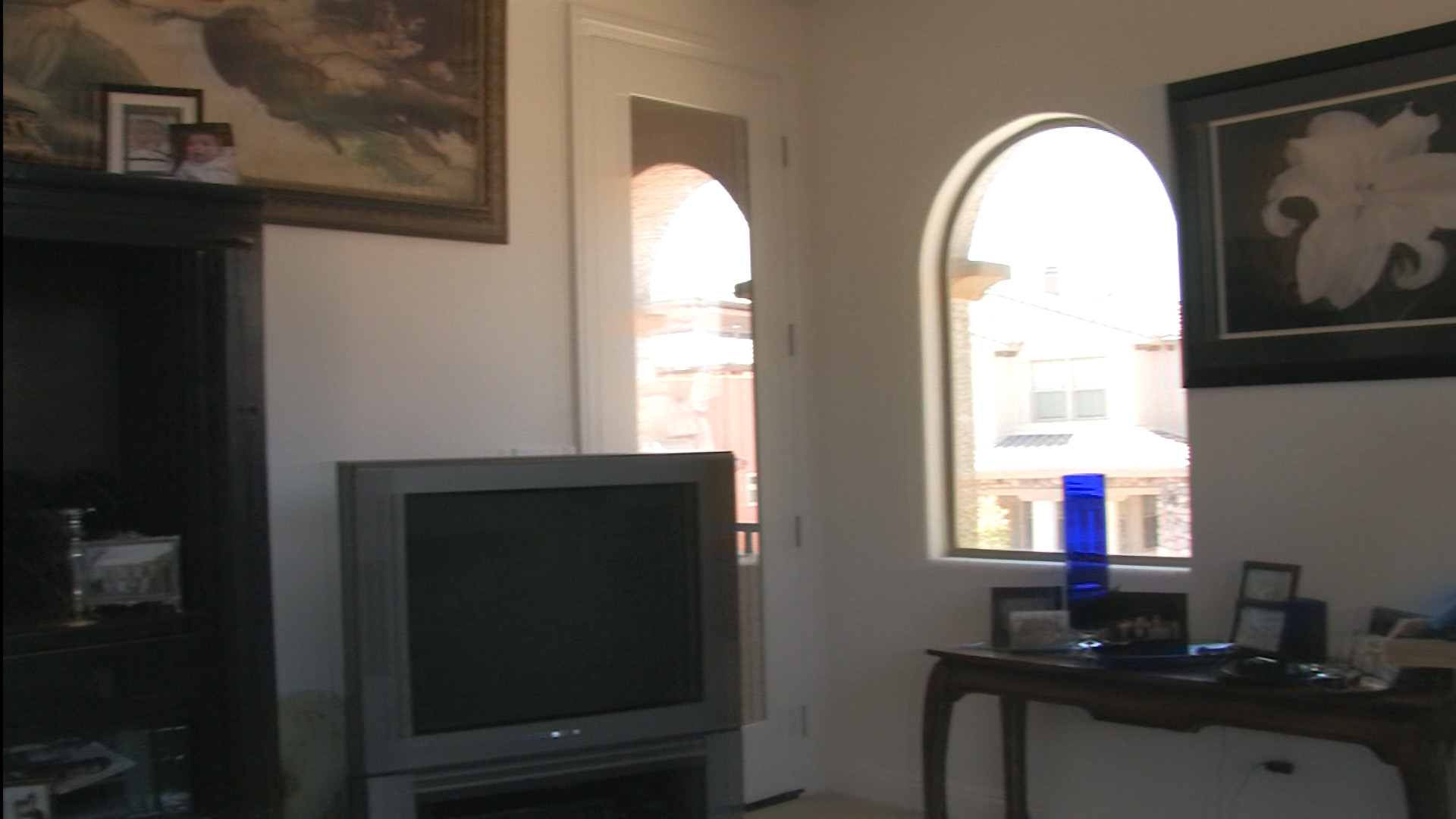

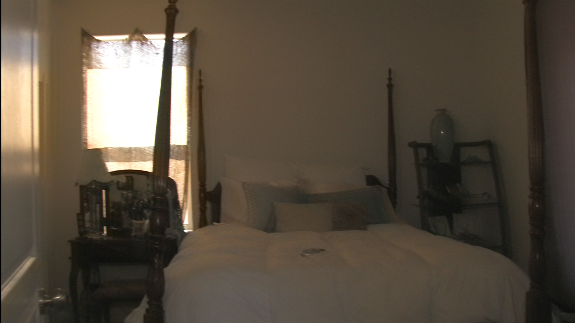

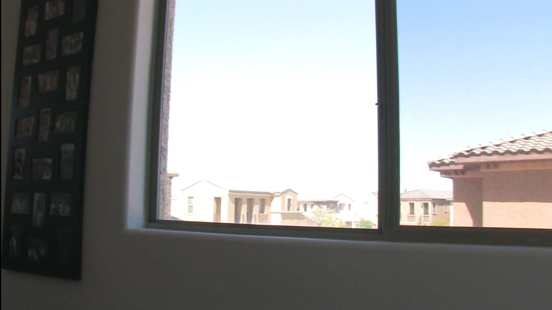

I first thought to shoot at night to avoid the bright windows, but having second thoughts. Except for a couple of small lamps, the place is entirely lit from outside normally, so maybe I should keep it that way?
Good thing is my Diva lights have daylight tubes as well as tungsten, so I can balance for daylight. Now, I still have to deal with the backlighting. I am thinking of a roll of ND gel to put over the windows (if I can find one), but not sure if that will do. I think I can get Lee 299 1.2 ND which is about four f-stops. Is that overkill?

My concern is that the ND will cut out so much light that I would not be able to light the interior. I am thinking that if I left alone the windows not in the shot that there would be enough ambient light. That would be tough to do if the subject moves through the apartment.

Your thinking is backwards.
Let's say for argument, that you cut out ALL the light coming in from outside. Then you've essentially created a situation exactly like shooting in the room at night. Today's camcorders are typically so sensitive that you can shoot under candlelight. So you can expect to get a sensible exposure in almost any interior.
By knocking down the windows to the MAXIMUM degree practical, you'll find that you can open up your camera iris and see BOTH the interior and the exterior perfectly well.
And any typical light you add to the interior in order to pop up your subjects, will NOT greatly affect the exposure of your windows since the exterior light is so much stronger than any normal interior lights.
So don't worry. Trust me. Gel the windows. Put up whatever lighting you have for your interior shooting, and I bet you're a LOT happier with the results than you will be trying to expose anything with those windows untreated.
Good luck.

Thanks Bill. I am definitely going to gel the windows. I have been advised that .6 ND might be enough so as not to cut out too much light. If need be I can double up. As for shooting in low light, the Canon XHA1s is probably not the best performer, so I want to save whatever light I can. I lighting guy in town wants me to rent an HMI to light the interior, but at $200 a day, I just can't do it without cutting into my pay.

The one part that I'm still failing to communicate properly is that you're thinking about that window light as providing general illumination for the room. And while it sorta does - the fact that it's sourced from BEHIND any people in the room means that it's not really FUNCTIONAL light from a camera's perspective. Yes, it lights up the room. Light from BEHIND a subject can ONLY function to outline it's shape. Period, that's it. In order to achieve an decent exposure on any surface NOT facing those windows, you need to either reflect that window light back onto your subjects. OR fill with additional light. And think about it. To ANY extent you dim the light coming in the windows, the FILL light will dim at the SAME ratio. You'll NEVER get additional fill light - you can ONLY lower overall light.
You'll ALWAYS be dealing with a lighting situation that makes your subjects look like they're in witness protection if your primary light is coming from behind them.
So by all means GEL the windows. Lower the overall light level AS MUCH AS POSSIBLE. Why? Because you want to make it EASIER to add the light you WANT from in FRONT of your subjects in order to make the subjects STANE OUT in the scene.
Hope I'm being clear here. Too little window treatment is WORSE than too much. In fact, you'll get a better shot by simply blocking the windows with blackout drapes or blinds and shooting under ALL front light - than by trying to gel the lights too little in a vain hope of having them illuminate the room.
THe light coming from the windows WILL NOT EVER be key light (unless you change the shot geometry and/or reflect the windows in a way that they become keys) And without KEY being stronger than FILL or RIM light - you will NOT bring your subjects into well-lit prominence.
Simple as that.
Good luck.

How much ND factor to knock down the window?
Iris down the camera and see how many stops it takes to get the window to the level you want. Then figure out what ND factor will give you that many stops.

Bill, I understood what you meant. The windows in the shot have to be gelled, period. The question is by how much? I still want it to appear to be daytime and the place has to look like it's being lit from out there.
Dean, I'm assuming you mean that I should light the interior so that it looks right except for the windows. Then find the proper stop down from there and add the appropriate gel.
To complicate things, the program is about interior decorating. I'm going to follow the woman through the tiny apartment as she points to various objects. It's a "before and after" kind of thing.
If I gel all the windows simultaneously, my lights may be enough to overcome the light loss. If that's not the case, I think I can break up the shoot into segments where I can gel or ungel various windows. I can use the windows that aren't in the shot for ambience and then use my lights for people.
I sure will be proud of myself if I can pull this off. My hat's off to anyone who can just eyeball this stuff.

A good topic. People always asking about various lighting instruments on this forum, when the sun is, especially for small/medium-budget day shoots, the 600 pound gorilla in the room. That makes ND rolls one of the most valuable lighting instruments around! (Just my 2 cents).
Alex, remember that windows face in different directions so the sun streams into them sometimes more and sometimes less directly, not only depending on the direction they are facing but also relative to what time of day it is. There's no one answer as to how 'dark' your ND will need to be.
Also keep your blocking and framing in mind. Turning the subject and if they are sitting, the subject's chair, a 1/4 to 3/4 turn one way or the other, could add or eliminate the window from the background. Put diffusion material in front of a window that's not directly in the shot and it could be a nice soft key/fill. I'm sure you probably realize this, but that's another reason why no one can give you a definitive answer.
Last but not least, if the apt. is on the ground floor and there is room to do so, you can go outside, put a tube of ND on the extension arm of a c-stand, unroll it and clamp the gel to another c-stand, again both just outside the window. It can save you measuring/cutting up a lot of ND and trying to stick it in the inside frame of the window.

I still don't know what you are saying. I know what the 180 rule is, but that is not the issue. The pictures at the beginning of this thread show that the small apartment is surrounded by windows - impossible to avoid no matter what angle I shoot from. I was just trying to figure out how best to deal with the windows in the shot (gel) and the windows not in the shot. As I move through the apartment, different windows will be in the shot, and the others (not in the shot) can become key/fill sources. I was thinking to gel in such a way that I can quickly take the gel down as soon as that window is no longer in the shot so that it can become a light source.
In a perfect world, i would keep all windows gelled and then have an HMI or two to light the interior. I would not need the light coming from the windows. Then I would light the people with my Diva lights. Due to lack of space and no HMIs, I have to use the windows for light sources.
