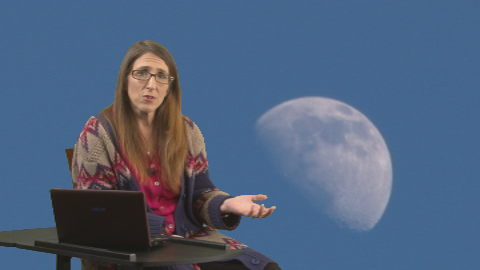

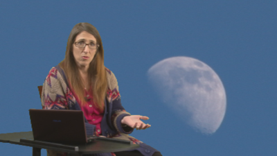

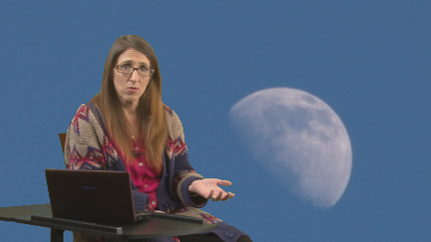

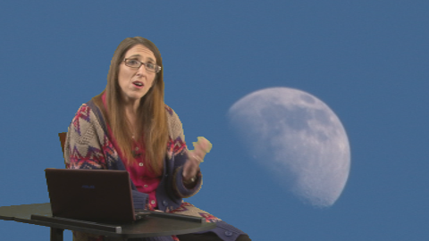

A few of our own production notes we've been addressing. Our test shoot was to test the system and see how well it all went together.
The dresser and desk both needed to move, they really limited the movement of the key and fill light. I raised the key light high to gain some distance. You can see the steep angle on the face of the netbook. (not an issue if we film at the cabin).
We found the mic set up below and infront of the talent was greatly effected by her hands. We bought a heavy boomed C-stand system and second MK41 super-cardioid to come from above (+ a lav)
We've been monitoring the camera on a very small display from a mobile DVD player, we now have 27" monitor capable being connected straight to the camera. The larger display is going to pay off for me, my eyes just aren't what they used to be.
We're going to use the 24" monitor as a teleprompter attached to the talents netbook, to keep her face on camera better. She's not reading a script, she just has notes and runs with it.
My wife is an experienced speaker and has done a few dozen voice-overs, this is the first time her delivery has been to the camera, which was uncomfortable for her at first. During the 3nd night she found her groove and really improved her presence and delivery. (She was a nat'l debate champ in college).
I washed out some of the color and depth with the constricted lighting set-up, and the ceiling reflections from the construction lights knocked out my depth from the back.
At this point it makes the most sense to film at the cabin where we have more room and we don't have to worry about competing with the nearby airport.
I believe the home-flo's will increase the value of my chroma. That more control with my talent lights will increase those values as well. Changing the location to the mountains will increase the value of the set. -- All very important issue that improve the total production value.
Bill mentioned the financials of the project; We expect the projects will pay themselves off inside of 2 years but having my wife home on Thursday nights makes it worth all the effort. ;)
I've attached some samples of the chroma results we got. Fast movement chroma ghosting bothers me personally, although it's mostly negligible to most viewers. I have 3 samples where you can see artifacts on her moving hand. 1) fast movement, 2) moderate movement, 3) almost still.
Lighting advice, time to purchase.-fastchromomotion.png   Lighting advice, time to purchase.-slowchromomotion.png

Looks like you are in good shape Mark, lighting looks natural.
