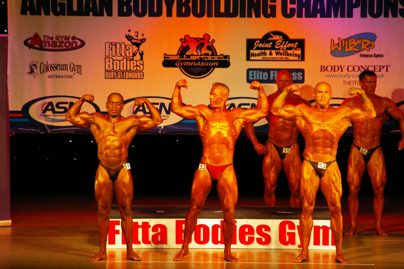

Shooting against blacks is a very frequent activity for me - as I do mainly theatre style events. If you want to attempt to shoot it as a traditional 3 point lighting setup, then all the comments about distance and power are extremely relevant. A space large enough to allow this kind of activity is going to be what? At least 6m/18 feet square to cope with people being thrown? So it introduces real problems as light spreads in width AND height, so to be able to cover a space this big means even with a key light on full flood, you cannot go to close because the people will get very bright as they move towards the key, and drop off as they move just a bit further away - so you could move the key further out, but we're probably talking 2 or 5K at least, and at 6-10m (18-30ft) away even a lamp this bright is actually quite dim. You are going to need a really big softlight and it gets messy. Image wise, as the people are on the move, you are never going to keep the key/fill angles right - so my advice is to forget all attempts at treating the area as one big one. Shadows are going to be a pain using this approach anyway, so our theatrical style approach would perhaps be best.
When we are faced with trying to provide even lighting over a larger area, we just split this into smaller areas and light each one separately. This means that as light falls off with distance, the light providing key in one place, may also fill in some shadows further away. Fresnels overlap well, their beams falling off gently at the edges, so for a space 6m/18ft wide and deep, I'd probably treat as a grid 3 sections wide and two deep. Each would have two fresnels, coming from 45 degrees each side of the centre line of each area. These will overlap nicely and the subjects and cameras can be positioned almost anywhere. I'd ensure the black drapes were far enough back to be out of any direct light path, and visually, they just disappear. This set up requires that the equipment for the furthest away row are probably going to have to be above the heads of the people when nearer the camera. You can hire stands, and lightweight truss to get the kit in the right place.
Downside, minimum of 12 1.2K fresnels - 650W would probably do if you have sensitive cameras otherwise the lower light level overall means less depth of field and with fast moving people, this will be a pain. Remember fresnels get quite dim when flooded out.
If you have big areas you simply cannot get good results with interview kit - it's just not suitable.
I've added an image showing a black background, with a performing area of similar size, and this area is lit by 12 fresnels, plus an extra 24K of front light that the organiser needed because a key feature was for judges to be able to see the muscle detail as the body builders struck poses. Even with this, you can see that just a few paces further back the light levels are lower. Ideally, I still needed more.
If you wonder why the colour balance is wrong - it actually isn't. Look at the colour of the white sign. They really ARE that colour - they spray it on then cover it with oil!
