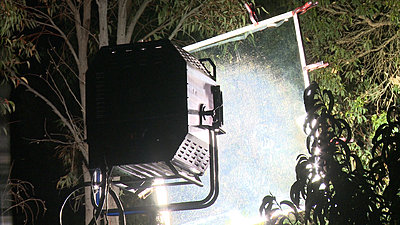

It lives. Local friend checking the lamp with his colour temp meter.

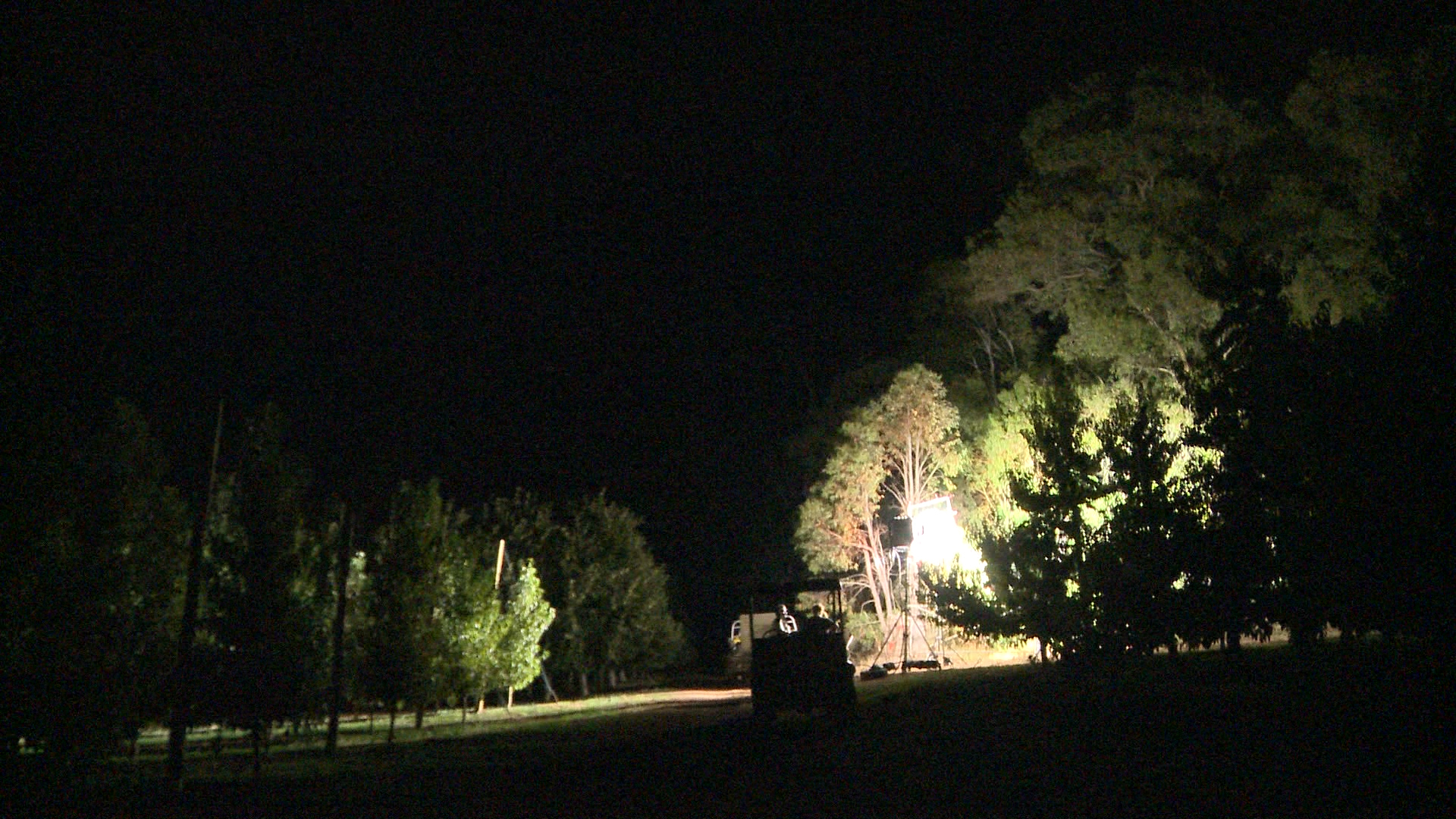

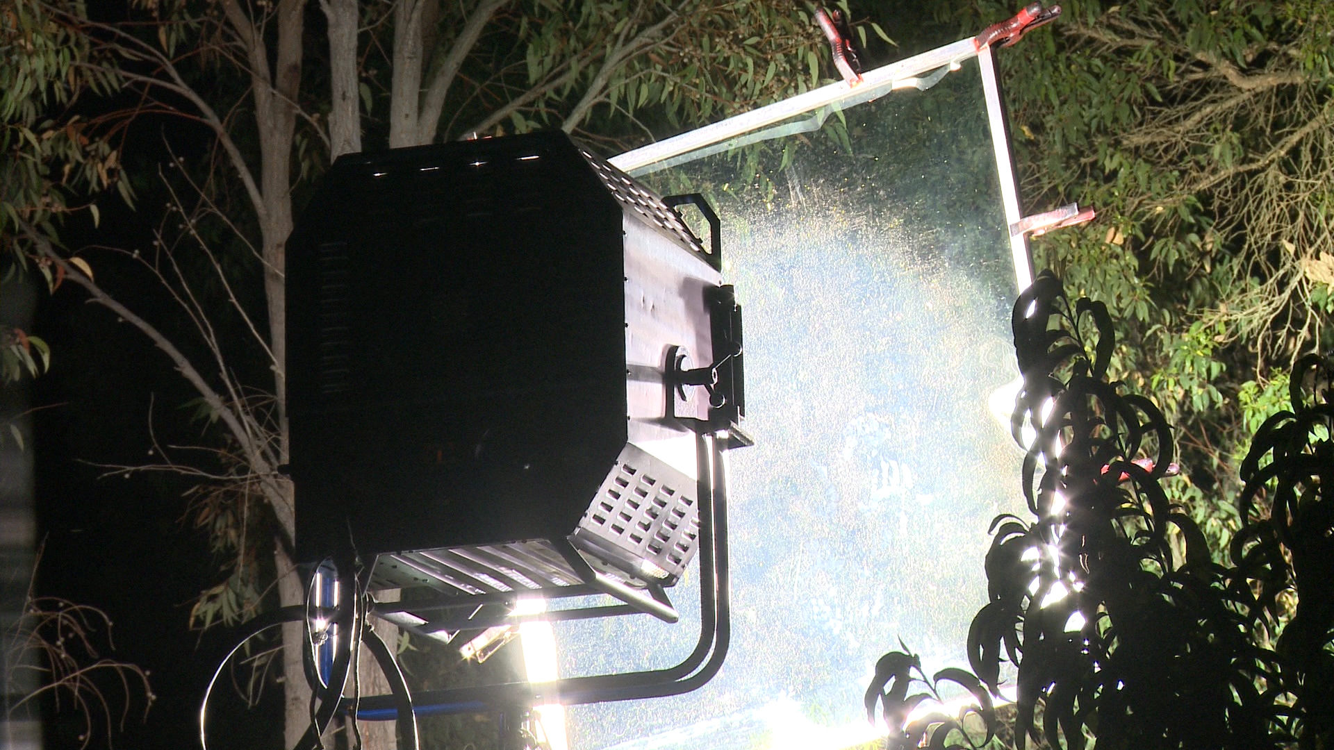

The final installment,the lamp on a production meeting its purpose and without being consumed by catastrophe.
There is implied non-disclosure regarding the project, an indie being filmed in Western Australia. This much by way of image can do no harm.
Thanks again to contributors of advice and knowledge here at dvinfo and at reduser for making this happen.
