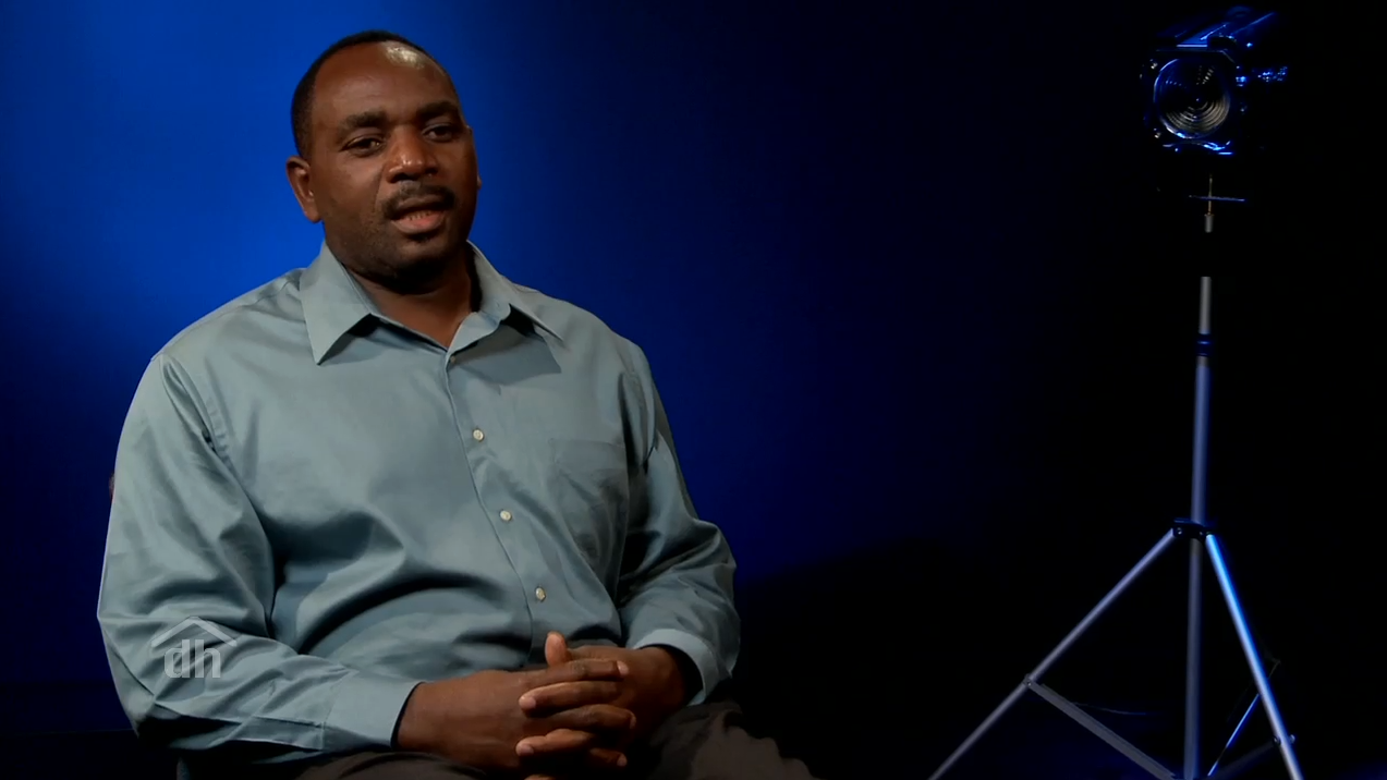

Throw a gel on a light to create a nice contrast on the wall and then light up your foreground subject as in the attached.
Lights in and of themselves won't help you. You need to learn to light. Look for an online tutorial on 3 point lighting to get started. It will take some time.
