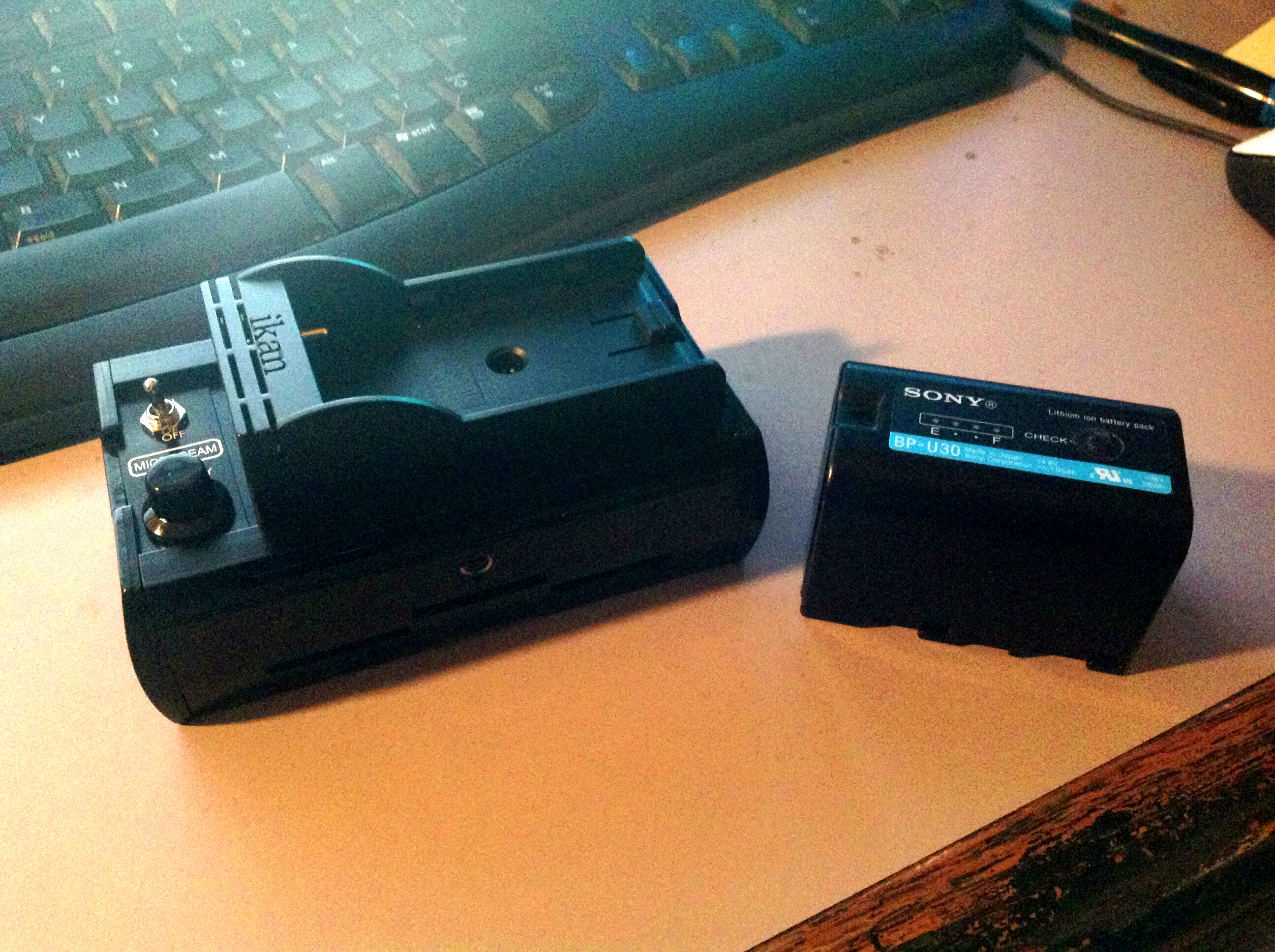

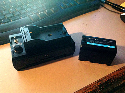

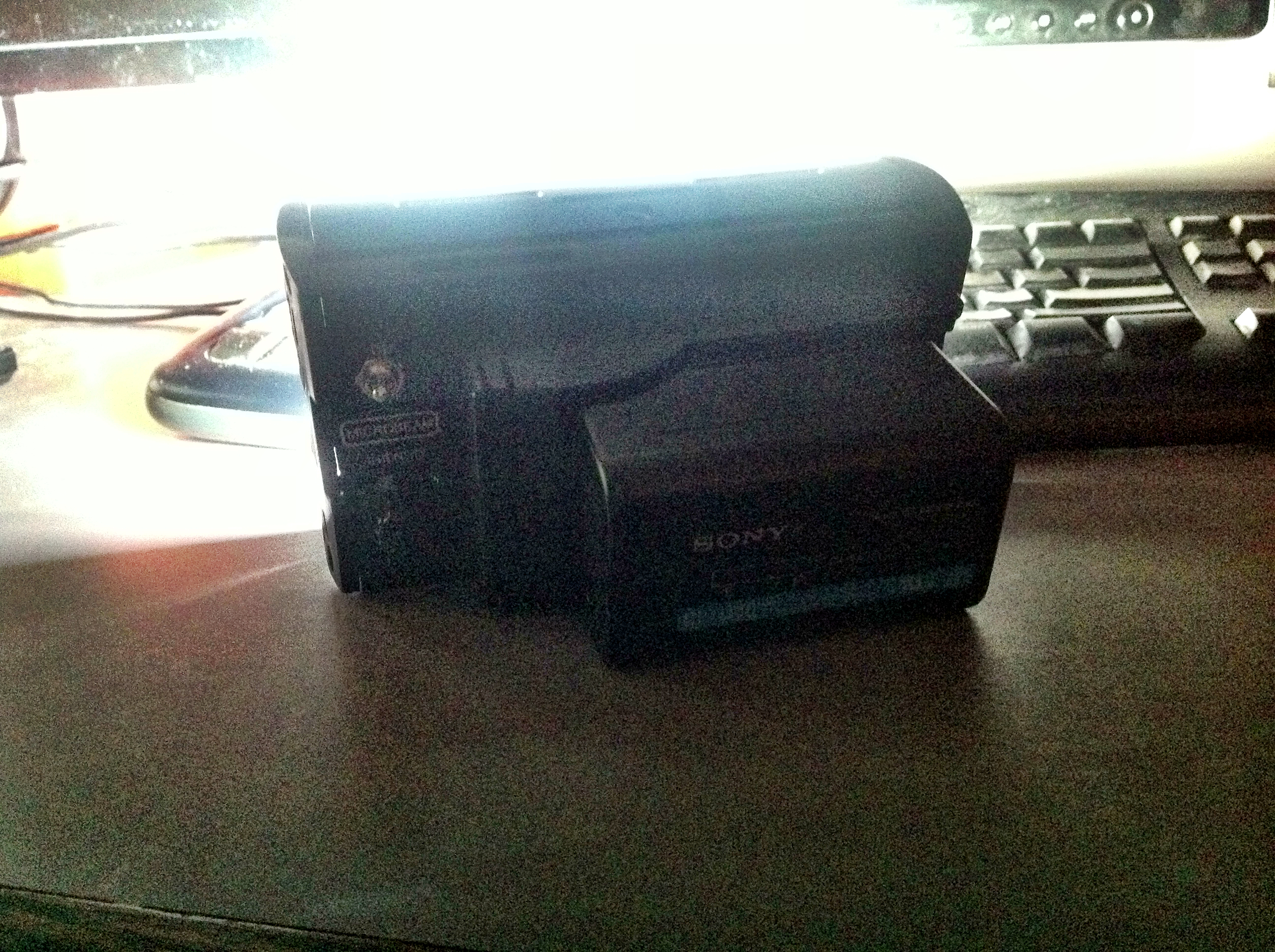

1 year later (and sorry for bumping the thread) but I have successfully done (with my friend's help) a BP-U Mod on a Flolight Microbeam 128.
Me and a friend looked into the internals of the light and found that the maximum voltage was actually 25V for the driver, with a 30V tolerance for difference on the PWM. We bought a Ikan plate (stripped out one board that was supposed to be leads) and soldered correct leads and connectors and drilled a hole for the single screw in the plate and widened another hole to patch the cables. It works.
Proof is in pictures, so here are some I took of the finished product.
This shows that all you need is the battery plate, some solder, wires, and a drill to install the plate. Basic electronics DIY project successful!
