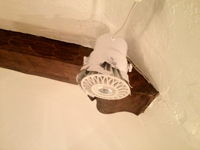

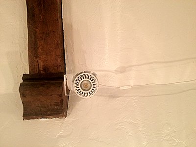

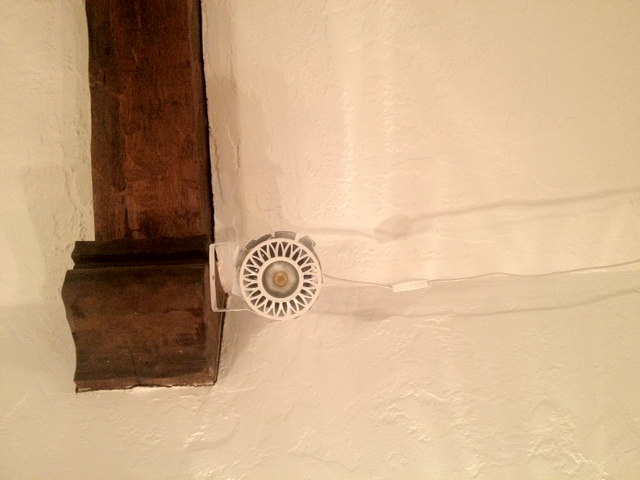

I think I might have solved it--at least as a proof of concept:)
Found a swivel lamp for really cheap, cut the metal around the end of it so it can take the wide end of the LED bulb, took off the base, then used the smallest nail with the biggest head I could find (that made a smaller hole than other nail holes that were already up on the beam but so small I never even noticed them) and nailed the arm directly to the beam. And since the arm is attached by a single nail there's a good amount of give between the arm and the beam so not only can I swivel the lamp its self up and down, I can also swivel the base its self clockwise or counterclockwise so the two articulations together give me pretty much a 360 degree swivel flexibility.
Note there are no makeshift barn doors yet or a little bit of pink gel to get the sickly ever so slight green tint out of the LED hue but with all those and with a dimmer, I think it'll work great and with low impact.
Oh, and obviously I just didn't have a tall enough ladder to place the lamp high enough. Once I have that I can place it half way up the beam and it will be invisible for 96 percent of any shots I can think of.
Oh and forgive the photo quality--just taken on your friendly every day iphone:)

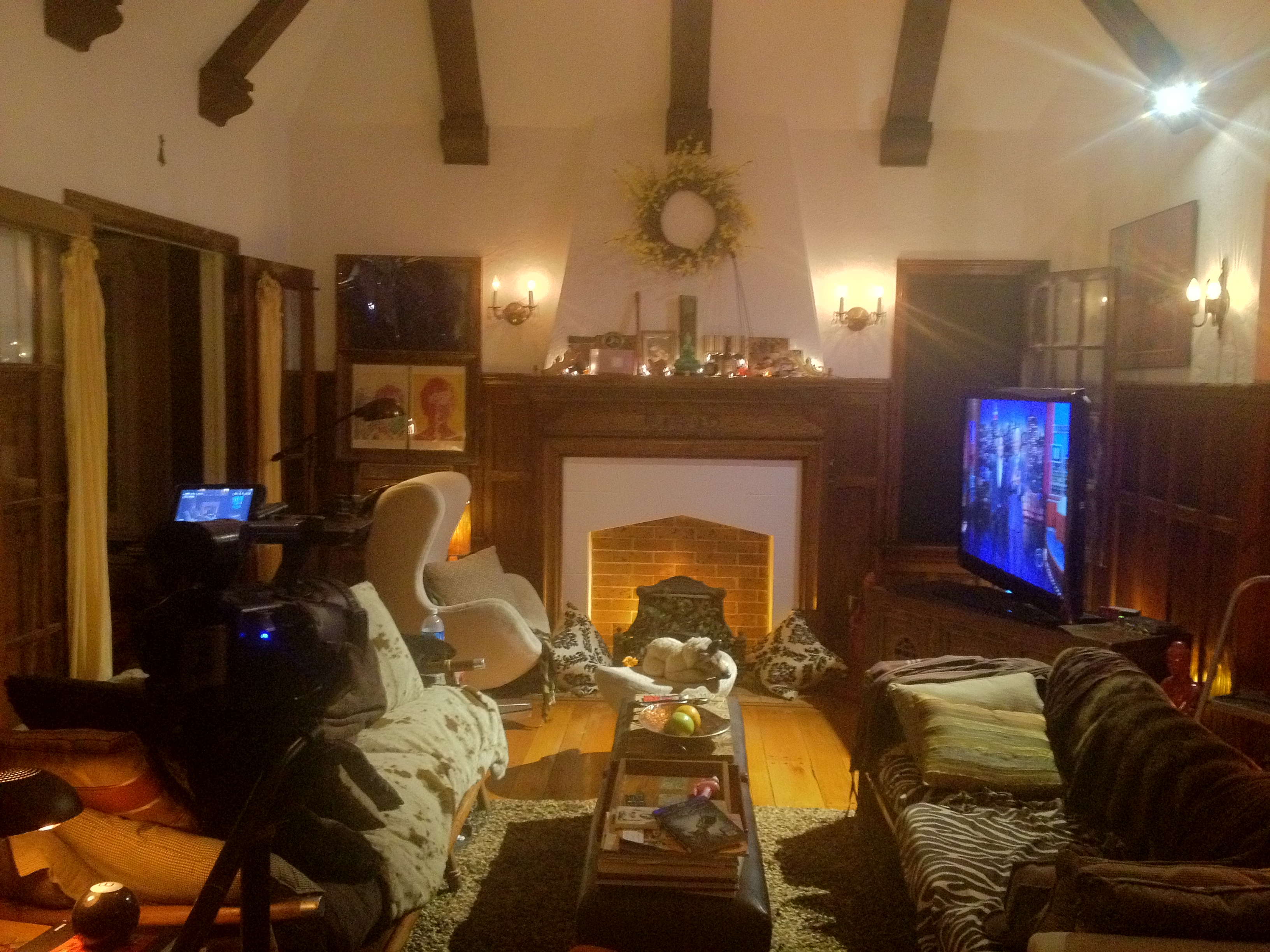

Thanks for the heads up:) Fortunately, maybe because it's the latest and greatest generation of LEDs we didn't have any problems during the sound test. Ironically the only thing we had to watch out for was a buzz that the wall sconces and chandelier would make at certain levels of dimness. I've got to say led lights have often looked a little sickly to me and thats why I was so surprised by how warm and clean the new bulb was.
