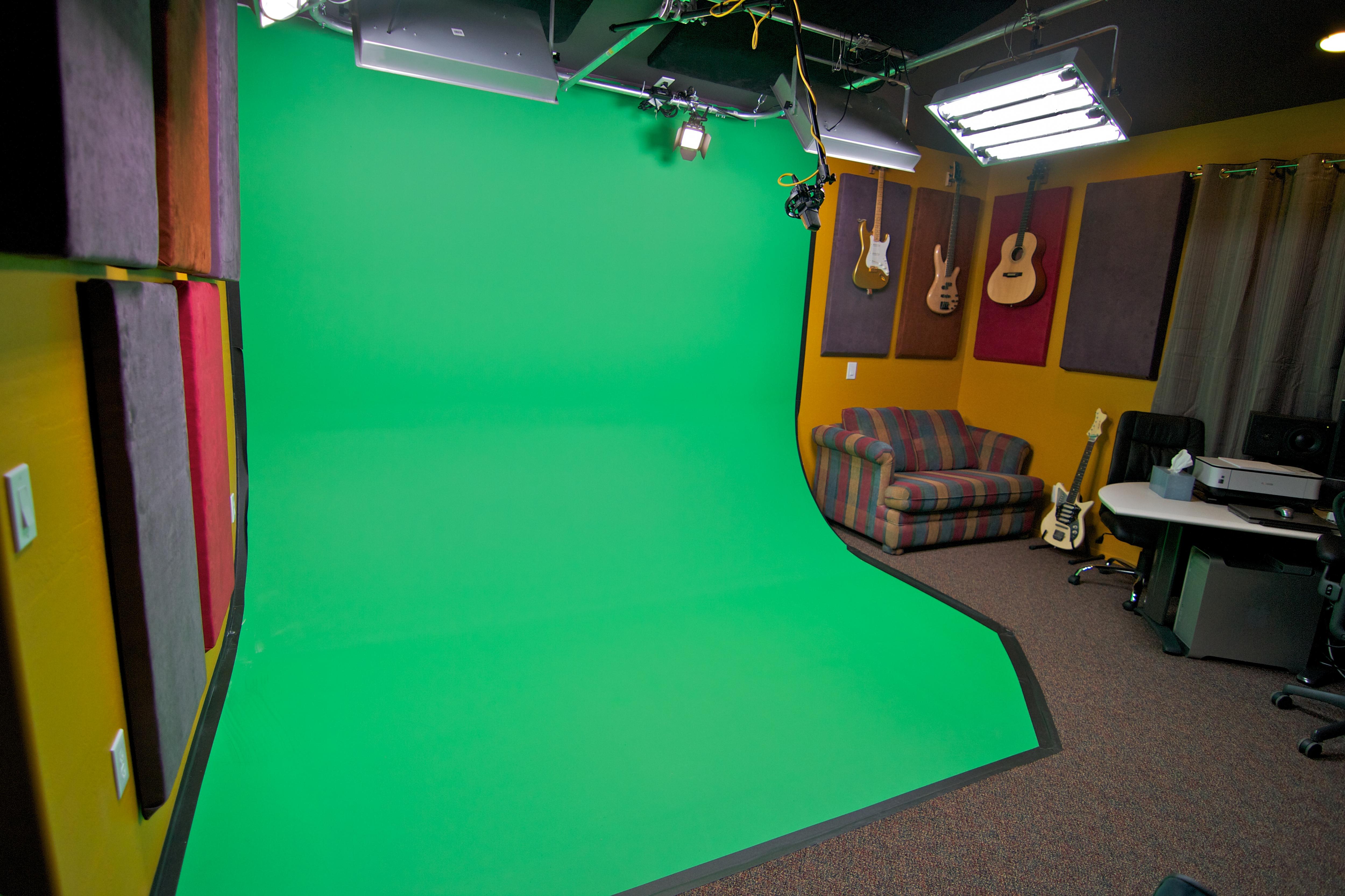

I built a different style using cake pans and the 55watt CFL Kino bulbs. Each head is 220 watt (4 bulbs 2 ballasts). The ballasts and reflectors were sourced from a fish tank supply company (ahsupply.com) and work beautifully. All-in mine were about $350 per unit including mounting hardware for the grid. They are not dimmable as they were designed for my green screen.
I might try building some of yours for other purposes!
Great looking lights and studio. I dig the rectangle pieces on the wall (almost as much as the guitars).
The ballasts came with the Lithonia fixtures and they are instant-on and operate above 42Khz. The actual part is ACCUPRO T8 MODEL AP-332IP-H-UNV. The first '3' is the number of lamps. They have a 2, 3 and 4 version of the ballast.
The biggest challenge I had was mounting them to stands. I'd much rather have a ball joint mounting plate but they're $85 each for Kinoflos. I used $15 articulating arms for monitors but there's got to be something better. GL

For mine I just used a simple yoke type mount, bent the aluminum myself. Before the studio was finished I did use them on light stands as the yoke has a standard 5/8" on it.
Ahh...and the rectangles are all rigid fiberglass acoustic insulation panels I built. Same materials as in the high end Auralex Elite and SonoSuede panels which cost a fortune. I got to choose my own fabric colors and each 2" thick panel totaled about $30 in materials. A bit more for the 4" thick. Compared to $100 to $150 per panel... worth the effort as I covered about 40% of all the wall surfaces. Room sounds great even with the greenscreen!
