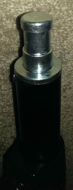

Hi all,
Apologies for what is most likely a very basic question. I recently purchased a couple of cheap light stands for my LED lights. I have attached a photo of the mount at the top of the stands. I've not seen this type of mount before and have no clue how it might be used.
My LED lights have a standard female tripod screw mount, so I'm hoping I can find some sort of adapter to fit on the light stand mount.
Have done some Googling but as I have no clue what the mount is called, I don't know where to start.
Any info greatly appreciated!

Looks like a 5/8" or "baby". Something like this should work:
Impact Rapid Baby to 1/4"-20 Male Threaded Adapter CA-101

Perfect. Thanks very much!

@Jody, just an FYI ... that's a standard lighting mechanism. Some stands have the male 1/4-20 as well. A stand like that would have let you mount your fixture directly. However, in putting the recommended adapter on your fixture, you get the benefits of fast on/off and easy/sure footed turning adjustments of the fixture at the adapter.

Or if you are a skinflint like me just drill a hole and screw (glue) a 1/4 thread rod in.

Thanks all, appreciate the info. I think I'll just go with the Impact adapter that Garrett recommended. Seems like a quick and easy solution.
