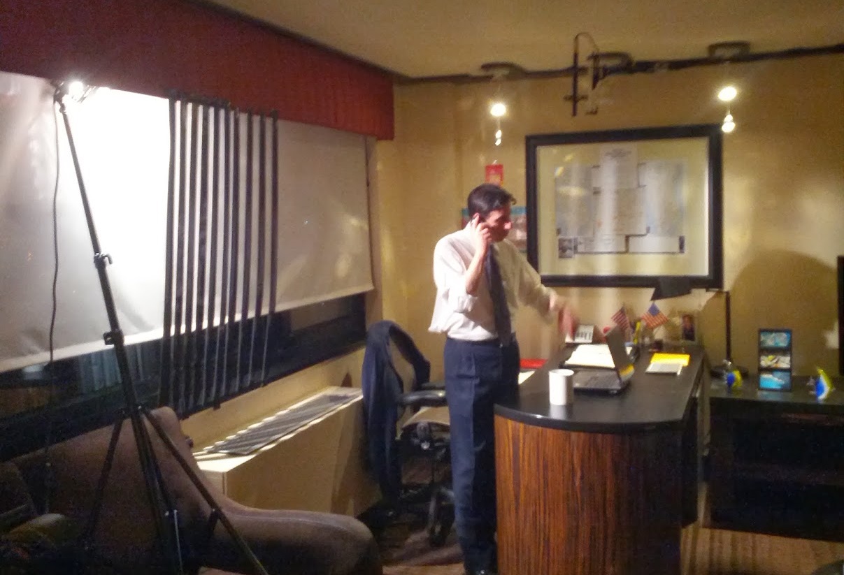

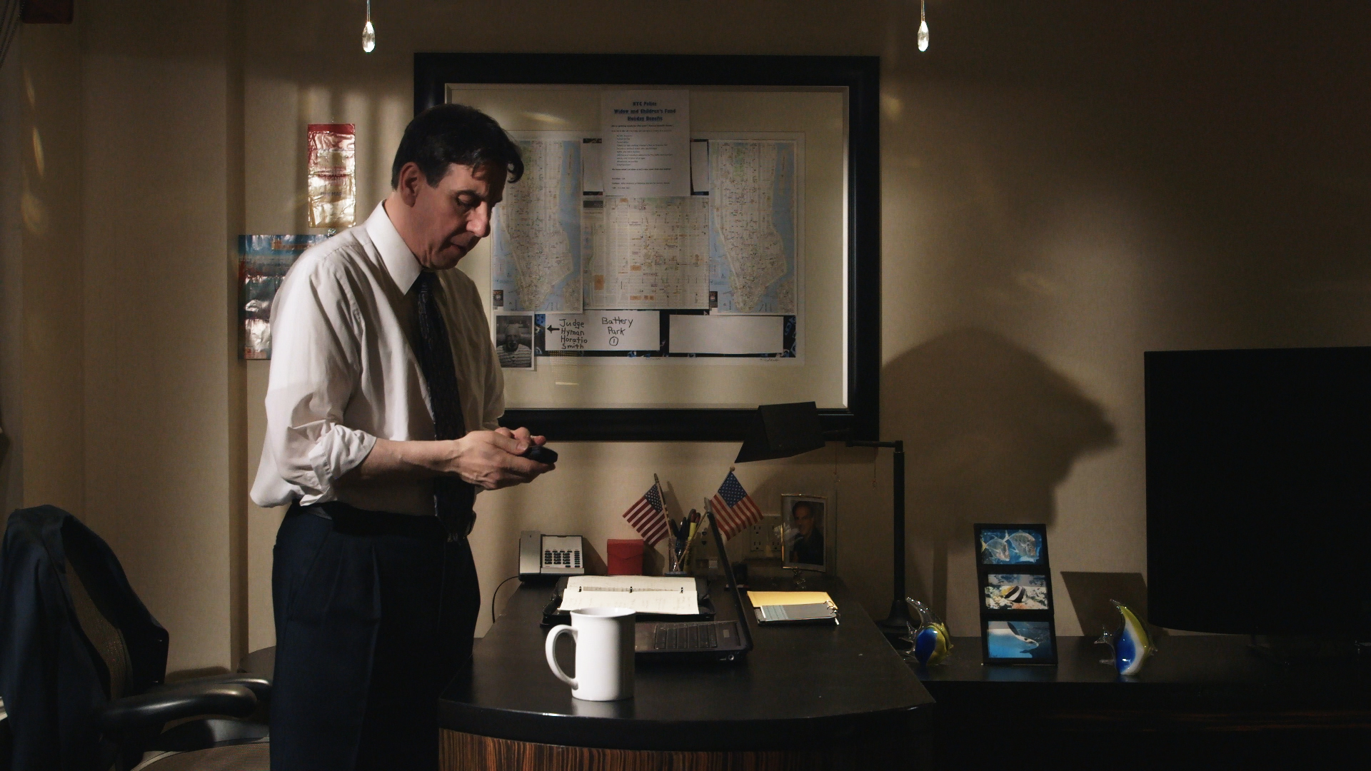

And although you specified your desire to have the windows in the shot, it's almost always easier to imply the sun vs compete with it. you can imply any time of day you want, and cookie it for any type of effect. You might even come up with something you like much better than your original idea since it frees you up to control it.
these shots are from the hairline budget feature i'm on. It was actually supposed to be shot while the sun was up, but it ran that far behind due to the location, and after getting the director to understand there is no way we could make our own 'sun' out there with the tools and access that we had. i made him the deal that as long as we never show the window, i can squeeze an implied sun out of it with a 250watt pro light.
note: those little lights do run hot, and it was checked after every take to ensure nothing was at risk. safety always!
and yes, i gaff taped a venitian blind cookie
Competing with daylight-590.jpg   Competing with daylight-img_20140216_223549.jpg
