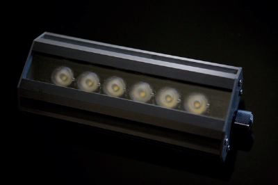

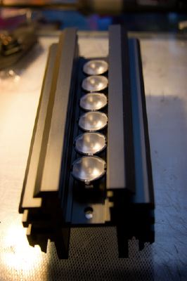

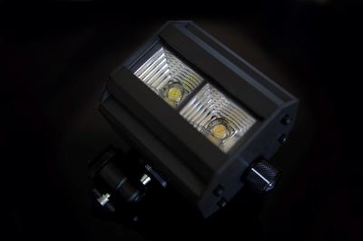

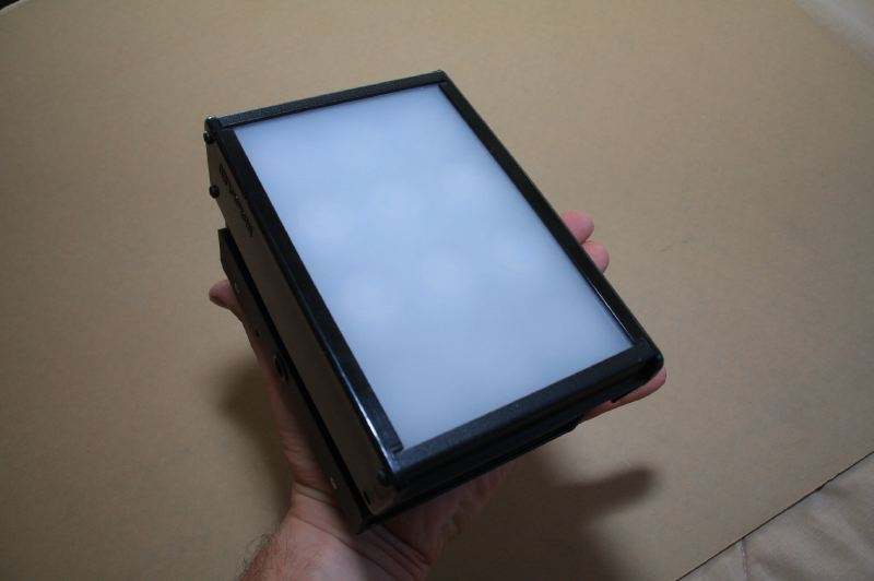

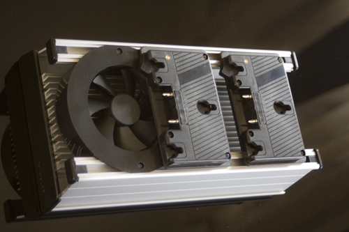

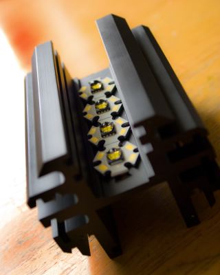

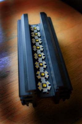

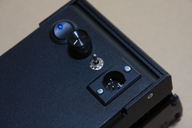

OK, for those curious to see what I use for bright cloudless days as a spot fill. The diffuser will widen the beam to 40 degrees with 1.5 stops less light.
The leds are lighting class 2000 lumens each. 6 leds are 3200K and 6 are 5500K. The switch allows 3 color choices, 3200-4000 and 5500K. Dimmer id non PWM type without banding or flicker issues at high shutter speeds. Small bettery plate is for the Sony BPU series 14.4 volts. The fan is Papst ultra silent, the casing is T6061 aluminum, the unit weighs 2 lbs without battery, all wiring hard soldered teflon, dimmer pot is mil spec Allen Bradley 500K turns.
Sorry, not for sale. Just showing what can be possible with high grade leds and components.

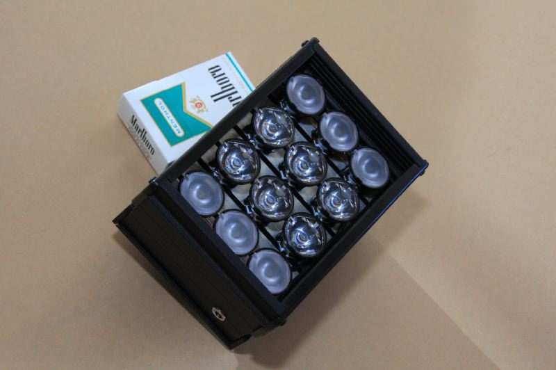

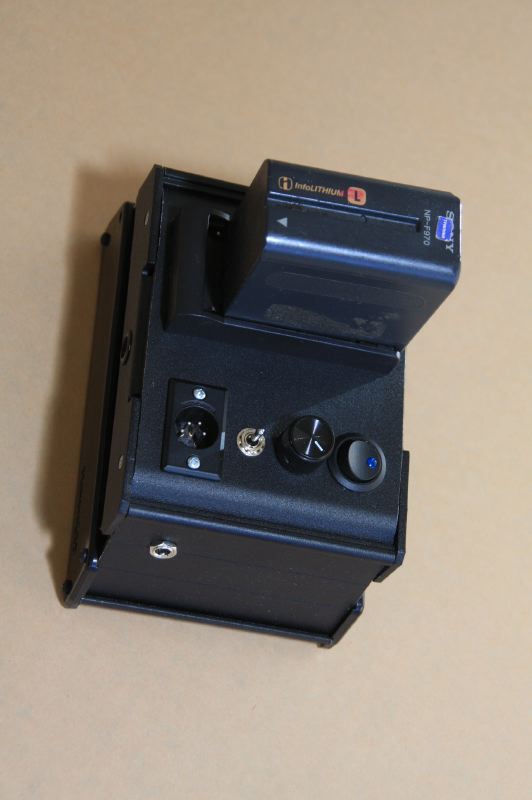

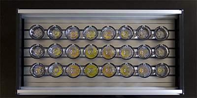

I recently made this beast for a friend who wanted small as possible with the highest brightness and battery operated. It measures only 12 inches across X 6 inches and 3 inches deep.
3 color temp switch, 580,000 lux @ 3 feet, consumes 200 watts from batteries, 50 minute run time at full blast, 90+ CRI @ 3000K, 85+CRI @5000K, 20,000 lumens or 1.2K filament equiv. 12 degree spot with interchangeable TIR optics for different beam angles, Macrolon Lumen XT diffusion capable, ultra silent Papst Fan.
Stop teasing! Don't share unless you'll sell us one :P

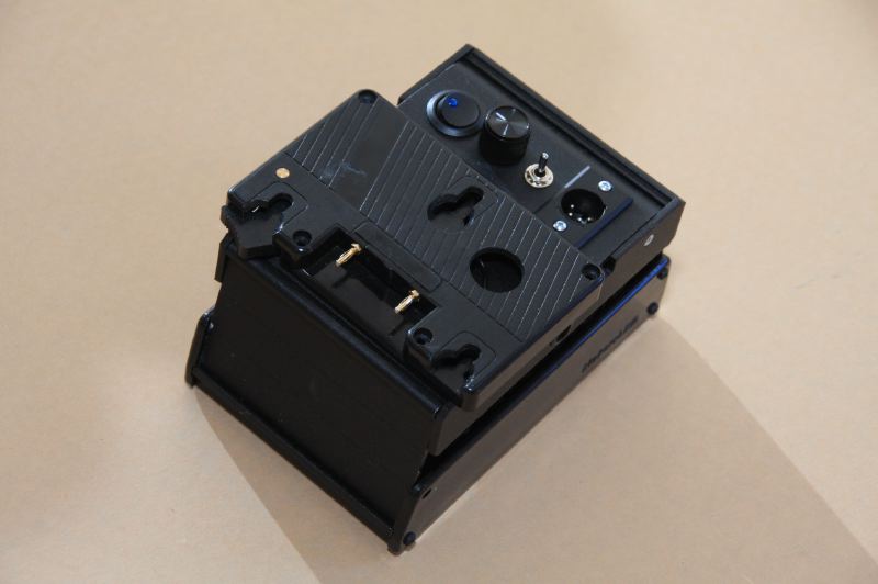

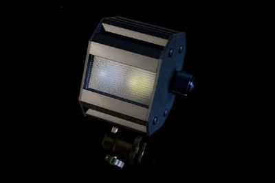

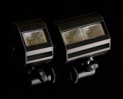

How about these prototypes ? The ones with the rectangular silvered reflector project a 16:9 rectangular beam pattern of 75 degrees with extremely low light falloff from center to edges.
Ok, no more teasing, promise.
