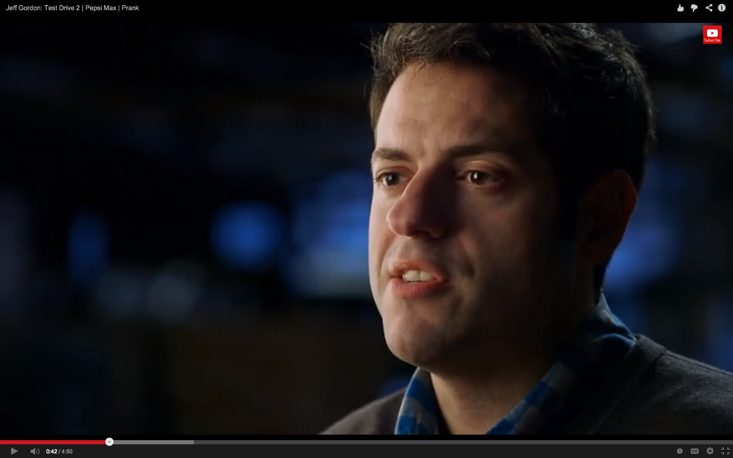

Yes, some of this does have to do with nomenclature. I define wrap more as the distance that the light travels on a subject, so given a traditional interview type setup with the source at 45 degrees as you mentioned, how far across the face does the source travel? I think we can agree that if a given frame isn't fully filled by a source, then by definition it will have less wrap (i.e. a 4x4 frame will become a 3x3 or 2x2 source), so obviously this will mean harder shadows and less wrap. So the baseline for discussion starts with a fully filled frame, at exactly the same transmission (reflected meter pointed at the source reading the same with uniform levels from edge to edge), and then the question is, does a given diffusion deliver a different quality of light than the next under those conditions. Not having done specific tests on this, my gut tells me that the difference is negligible at best.
Once you start extending the width of the source, the light will travel (wrap) further around the subject, which will fill in shadows and become softer. Again, I'm sure we'll agree that two 4x4 frames next to each other will make a substantially softer and more wrappy source. And generally we'll need another instrument, one for each frame. But here's an interesting wrinkle (so to speak): what if we used a lighter diffusion, so that the frames weren't properly filled edge to edge, but still a 4x8 source? Would it be wrappier than a 4x4 frame completely filled? By definition, the light must travel further and the shadows will be more filled with the 8x8 source, but there is a different quality to harder light, so it won't read the same on the face, particularly on the far edge where the dropoff to shadow will be more severe.
Another variation of this would be to go ahead and fill the two frames with your fave diffusion, but have the two lights at different intensities. Below is a still frame from a commercial I did where I had two book lights adjoining each other, making a 4x8 source, but I had the one on the left a stop or more hotter than the one on the right. The result is still a single source in the eyes, but as you can see the light appears to fall off across the face in a way that wouldn't happen with a smaller source, or one that had consistent output from side to side. What kind of diffusion did I use? Couldn't tell you, this was a year and a half ago and it was one of many, many setups that day.
That all got a little academic! Hope you were bearing with me.
On the scenario you described with the toplight--my instinct is to believe that the lighting instrument was close enough to the diffusion that the 216 wasn't able to create a smooth field, that it was a little center-hot, and that the full grid was, but probably with less transmission. But you have me intrigued, and I am going to see if I can sneak in a little lighting test with my guys on set this week, a shoot-off betwixt full grid and 216 if you will! If I do so, I'll make sure to provide stills.
