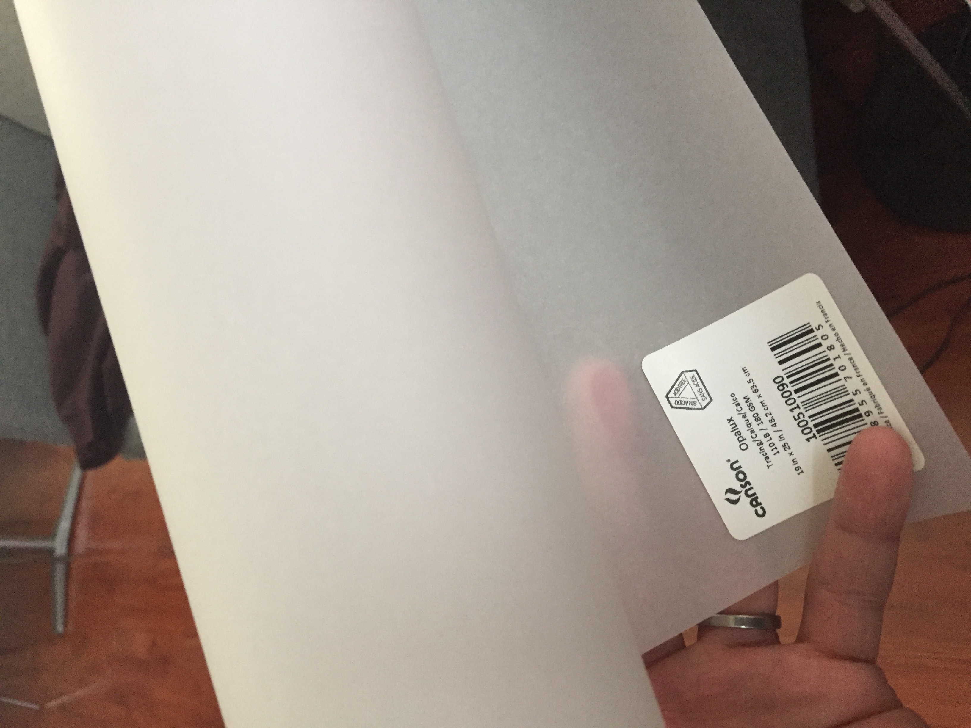

Old January 7th, 2017, 12:52 PM   #13
Location: Rego Park , NYC
Posts: 665
Re: Diffusing material
You might check out BLICK art materials. I bought a sheet of Canson Opalux 19"x25" for I think $5-6. Seems like it would work as a diffusing material.
John C. Chu is offline   Reply With Quote
