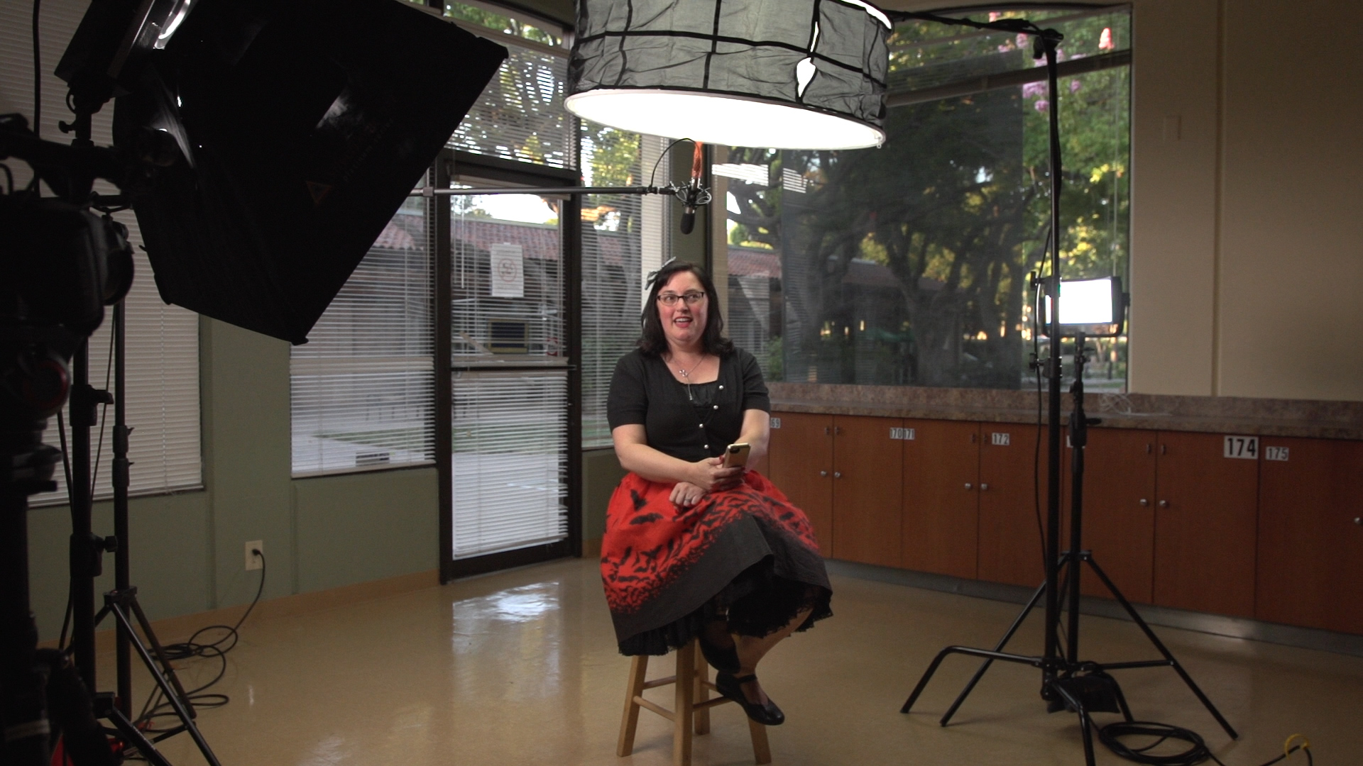

Here are a few examples (both indoor and outdoor) that were shot a couple of weeks ago during an interview lighting workshop I was teaching in Maine. Most of the setups were done with my Litepanels Astra 4X and my Astra Soft. The goal of the class is for the students to learn simple techniques for setups that can be accomplished by one person in about 30 minutes with gear that can be carried on a cart.

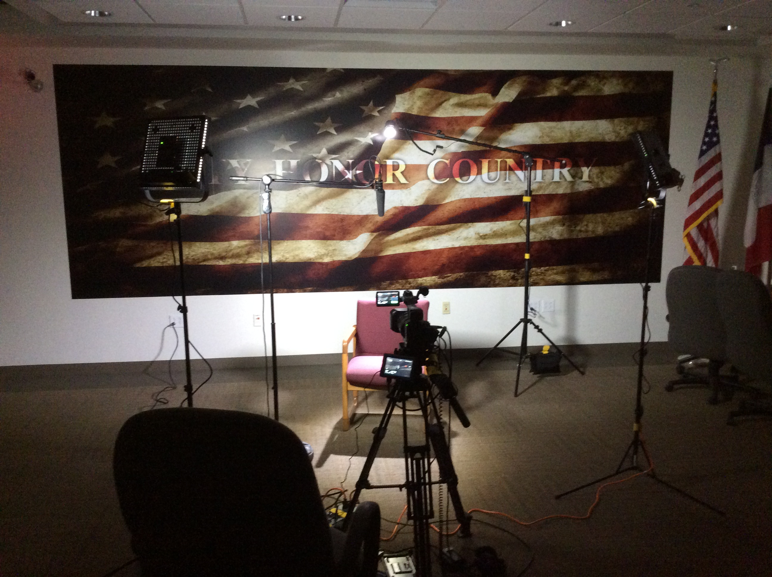

This is how I set up for my monthly veteran oral history interviews. Key light: Litepanes 1x1 daylight flood. Fill light: Litepanels 1x1 daylight spot. Hair light: Litepanels 3" ENG.
Lighting For Interviews / Talking Heads-img_0019.jpg
