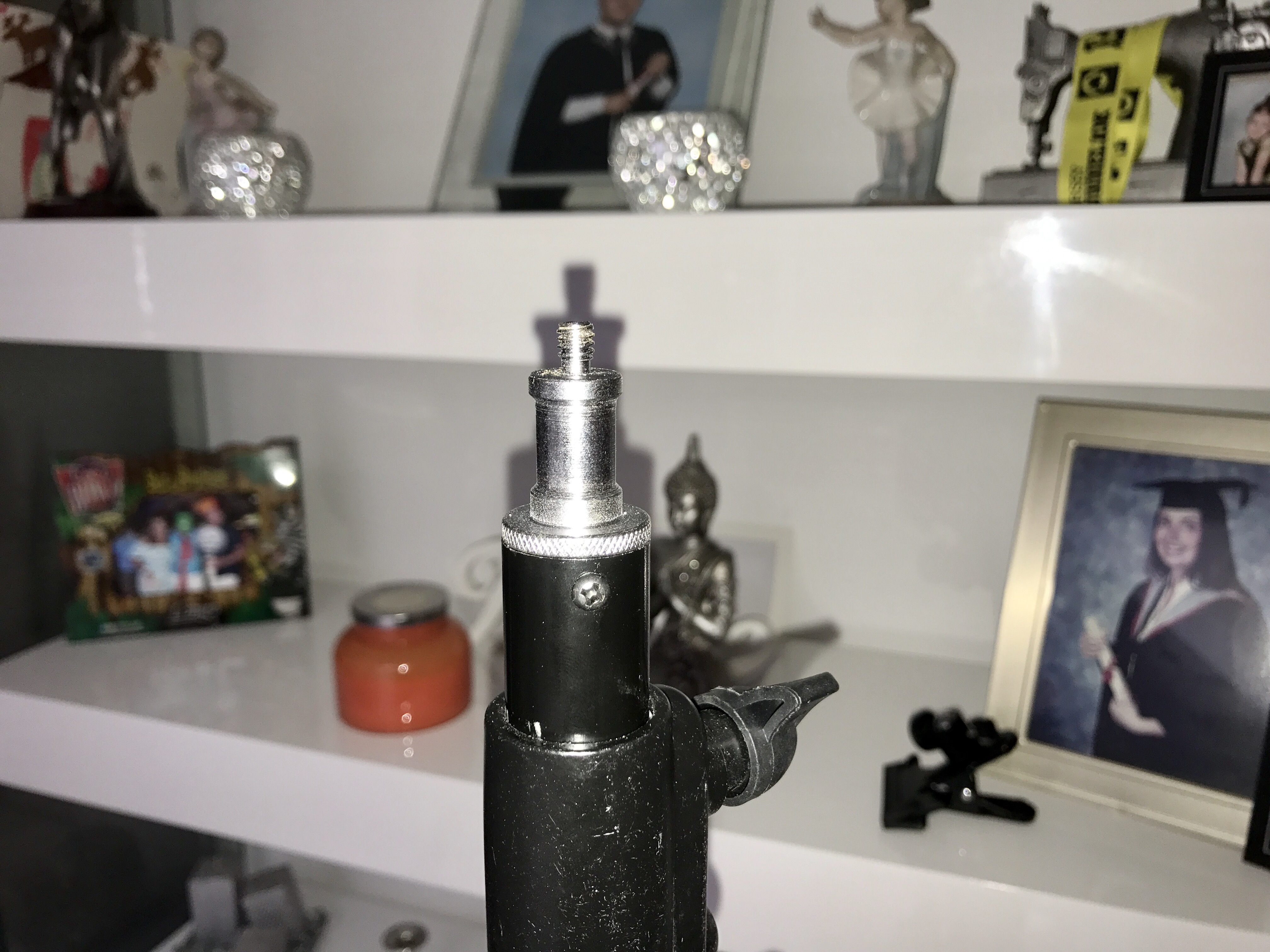

Hi guys, I have a couple dark venues next week and want to use my halogen lights on a stand but need some kind of adapter to clamp onto light then screw onto light stand thread ( see picture) steve

I think you're looking for a TVMP adapter: https://www.bhphotovideo.com/c/produ...P_Yoke_to.html
You have a baby pin stand, and you want to attach something with no stand connector at all, right?
There's also a light duty one that has a 1/4-20 stud at the top: https://www.bhphotovideo.com/c/produ...n_adapter.html

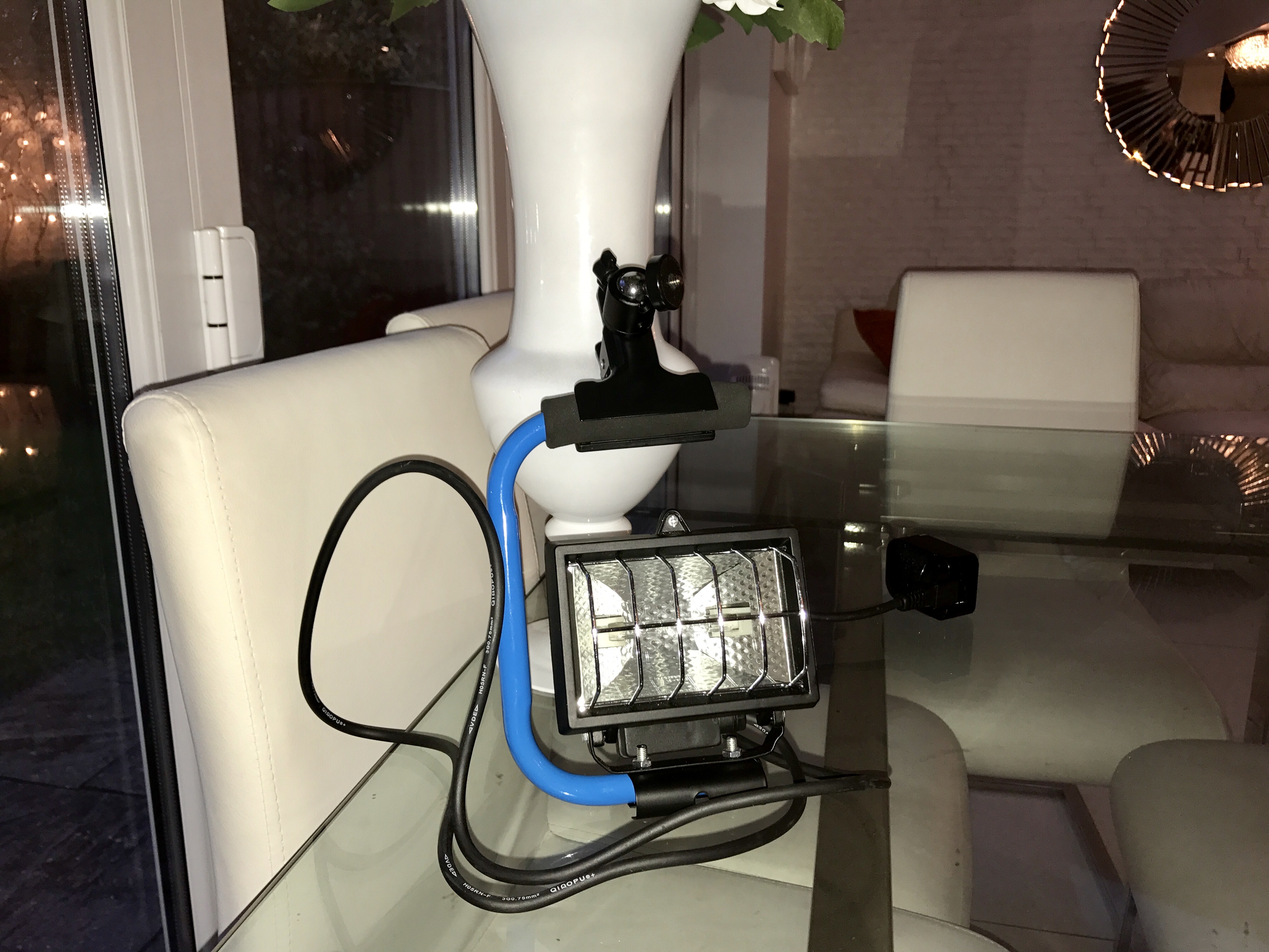

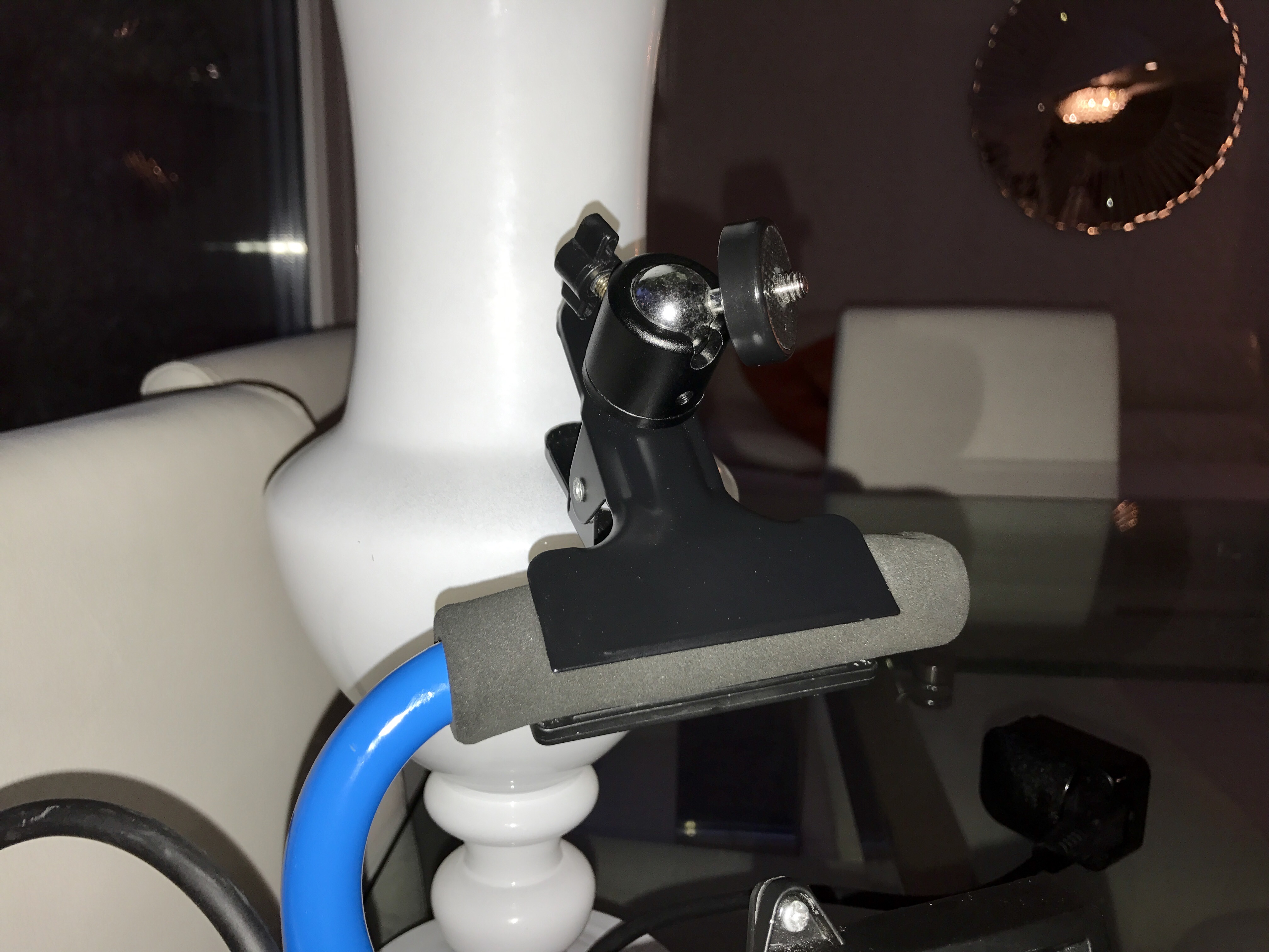

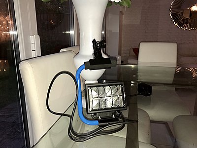

Cheers nate that might do it , but may be to small, here is the hologan light that's great and a clamp with the male thread on the end that needs to go into female, but the top of lightstand in earlier picture also has a male thread. So I need female one end to go on male on stand then the male from lamp clamp to go into female. Phew might do what Peter has get two red heads! Haha

Steve, that spring clamp on the light's foam handle doesn't look sturdy enough to mount to any stand, especially with another adaptor in the chain.
There is not only torque on the spring, but on the ball, adaptor and 1/4 20 thread as well.
I think your idea of getting a couple of used Red heads is a good one. :)
