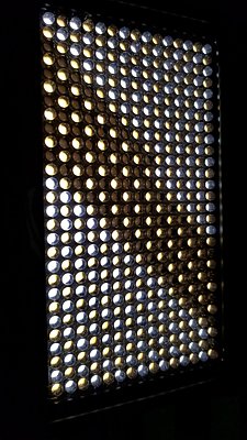

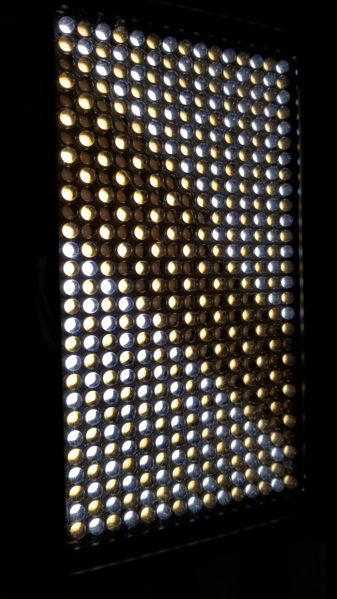

One year update on this LED panel. It has begun to fail, and after paying $320 shipped with tax a year ago, the price of new units is $130 at B&H, so I feel a bit pissed.
Ikan can offer me no assistance, even considering the amount I paid.
