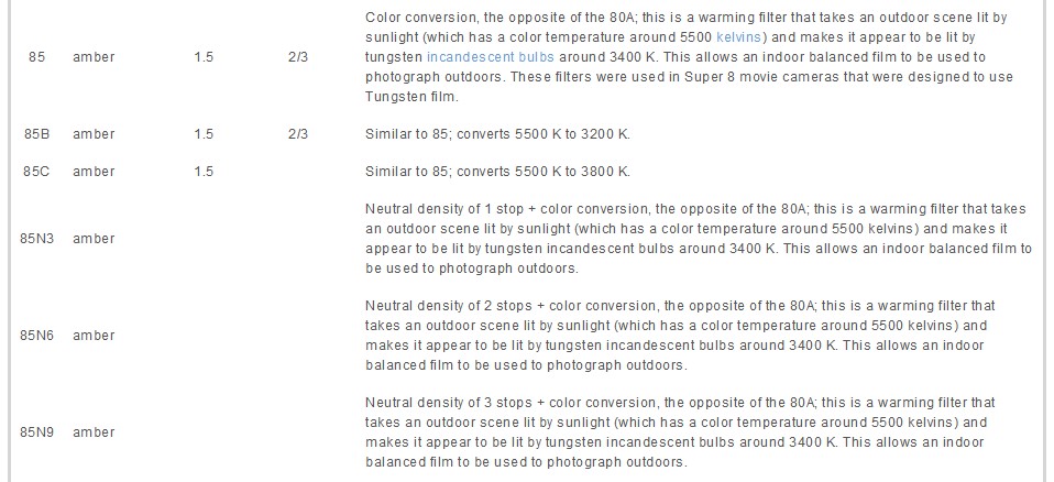

If using filters a Wratten 85 will take you from 5500K to 3400K. This is what we traditionally used when shooting with film. Watch out for melt temperatures if mounting the gels inside a softbox. Most likely you will have to experiment. See table and Rosco links below :
https://www.timlaytonfineart.com/wratten
https://au.rosco.com/en/color-filter...nment-lighting
Chris Young
