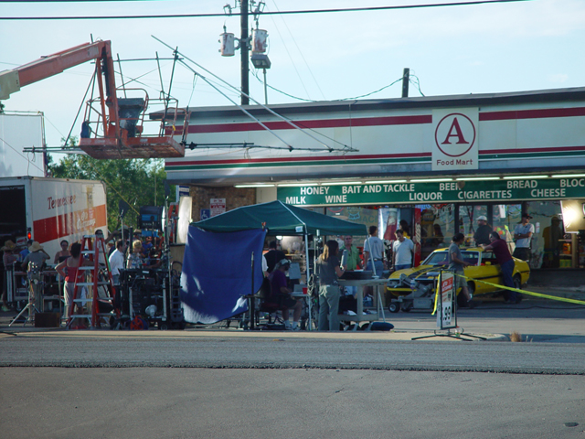

They were shooting a movie, with Kirk Russell, and I was told, Russel Crowe with Quinten Tarentino Dir., (I probably misspelled everyone's names) close to my house last week.
I took a photo of their shoot. Notice in the top left a large scrim that is being held up by a boom arm. The scrim frame is made of pipe.
Large scrims are used all of the time.
Click on the pic for a larger view.
The blue tent is for the director, the sound board and monitors.

Thanks for that picture, Jesse.
Notice the other large scrim on the far left of the screen. It is standing vertically and probably on the southern side of the set if it is in the middle of the day, on the west side of the set if it is later afternoon, and on the east side if it is morning. It looks like they are using a big HMI just to the left of the blue tent. The electric lights are probably to add an element of control to the lighting.

You're right. The vertical scrim is on the Southwest side of the shoot, about 5:30 PM.
I didn't even notice it before you mentioned it.
