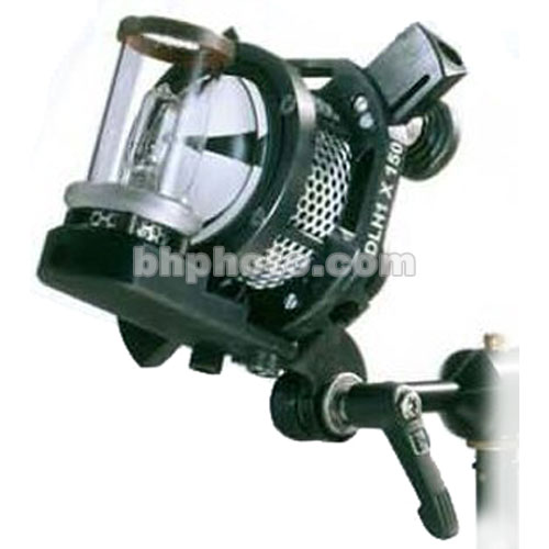

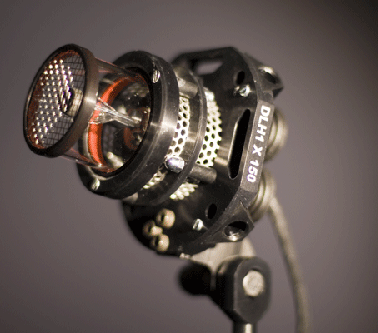

DLH1X150 Design Change
The DLH1X150 I ordered from B&H arrived. To my surprise, it looked nothing like the picture on B&H site or in the Dedolight catalog - the reflector mirror is gone, and the lamp is not vertical but horizontal, like all other dedo soft heads.
I thought there was a mistake, but there is a clear label DLH1X150 on the head, and it does work from their 24V power unit.
I spoke with B&H, with their intermediate dealer Visual Departures, Inc, and finally with someone at Dedotec. At first everyone denied the possibility that the light I was holding in my hand had any right to exist.
Then the person at Dedotec found out that the design had indeed been changed by the factory (although no one was told about it) as the light output of DLH1X150 in a Dedoflex small (12"x12") softbox did not change whether a reflector was present or not.
Testing time: I put the mutated DLH1X150 with its 150W bulb in a Chimera XS box next to my Rifa 44 with a 250W bulb, half-expecting them to be about the same brightness - but no magic: Rifa is about twice as bright. Duh! Of course a 250W lamp will be brighter than a 150W!
Hmm, I thought - what about the claim made about the DLH4X150S, which is just 4 DLH1X150s (original design) put together: it is supposed to provide "almost as much light output as a 2K Fresnel with a softbox". Simple arithmetics: 4 lights - 2000W, 1 light - 500W. Ok, with a softbox with 1 stop diffusion screen it should be about half. or ~250W. Should be brighter then, say, the above Rifa 44?
So now I am confused: is the reason it isn't particularly bright is the design change or simply my high expectations and laws of physics?
Now, the light it creates through Chimera box is very nice, and at the brightest settings (3400K) it is noticeably less yellow than the Rifa. It will work very well as a soft fill for portraits, but the light will need to be right in the face of the talent. If, as I often do, I need it to light two people for an interview in a hurry (which is how I use Rifa) from about two meters away, the light output will not be enough.
The fact that the light is dimmable is rather useless to me as well: it is not bright enough even turned all the way up. But I am sure other people will find it useful.
Thought I'd share my observations.
The pictures below illustrate the design change: the picture on the left is the original design advertized on B&H site, the one on the right is the new design.
The one I have is the one on the left. DLH1X150, SN1027.
I've done direct side by side comparisons with a Rifa, and I chose the DedoFlex. The light, the output, the dimming and the 'it goes to 11' setting made the choice a no-brainer. It honestly matched the Rifa for output. Egad, what have they done?!
Hmmm.
