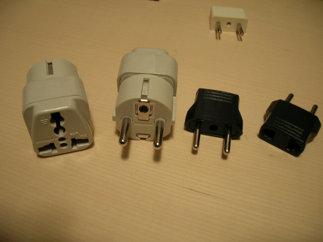

Umm... I'm not an electrician in 120v land, much less 220v. Use at your own risk; what I've described below worked for me.
Originally Posted by Mark Zaller
Seth or others,
How does your overseas kit handle 220 volts?
Do you have:
- a 2nd set of 220v bulbs and power-cords...
A set of 220v bulbs (about $24-35 each), and power adaptors to use on my existing cables.
Be aware that for the most common european plug (two parallel round blades) there actually is a grounded version, which you want, which has a round plug body with a grounding contact in an indentation in the plug body. This grounded version also has thicker blades.
However, I've not travelled all over europe with these adaptors (my last trip was to Turkey) - and different countries can have different systems.
I purchased bulbs at a local grip & lighting supply and online. My adaptors came from Fry's. I probably spent a little over $100 getting the kit described above onto 220v. (BTW, some countries are 235 or 240). I used all US-style extension cords and cube taps.
There are online sources that will tell you what plugs & voltages are in use in what countries - sorry, I don't know of one that is authoritative.
If image attachments work for me (first time), see the photo below and click on it for a larger size. The two adaptors on the left are the beefier, grounded version that you'd want for lights. The black ones on the right have thinner pins, and are great for your battery charger & other small stuff.
