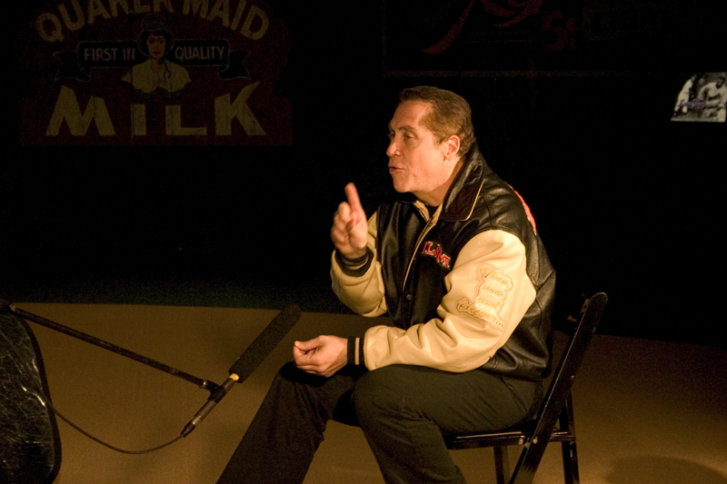

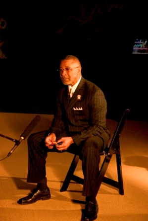

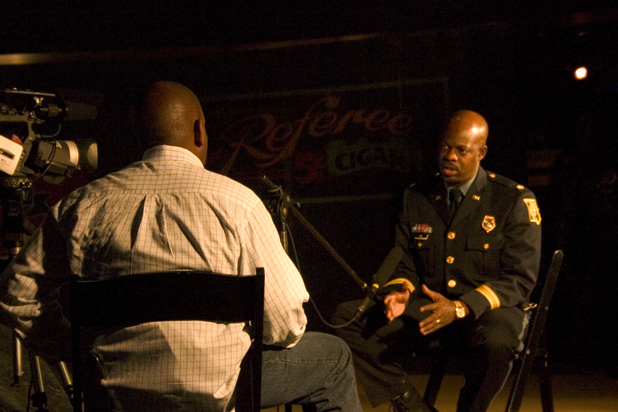

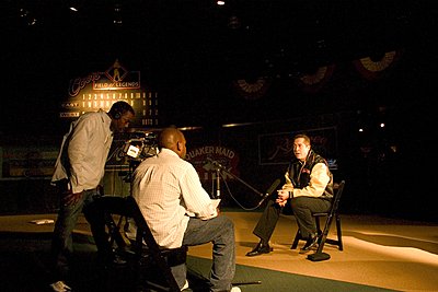

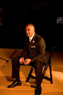

I worked on a production recently were we used a similar setup. It was a piece for MLB and the director wanted a similar look to the one you are talking about except with a 3:1 lighting ratio. Since all the shots were head and shoulders it worked really well.
We only used two lowel DP's. One with moderate diffusion as the key, the other as a backlight and a 2' x 4' gold reflector fill to warm it up a bit.The only problem we had was people walking through our setup casting shadows everywhere.
