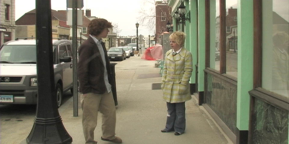

As for outdoors think of it this way if you take a digital camera outside can you take a picture? Answer, most of the time yes, you will however get better video shooting in the early morning or late evening( The Golden Hour.) Shooting during the heat of the day can be done you just need to be more aware of what the light is doing and how it is changing. Shadows glare direction etc.
Using reflectors scrims overheads etc. will give you more control over how the scene will look.
Attached is a screen shot that was shot about 5:30 am just after dawn.
Notice the even lighting, just enough shadow to give some definition, no glare, really cool reflections in the windows. We get contrast between the actors by their position. The female talent is facing more toward the light while the male talent is looking away. This puts emphasis on her as he turns toward the camera more emphasis is placed on him as his face lightens and he approaches the camera.
Bill
