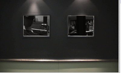

Update
Thanks for the replies so far! Here's an example of how we want to make the set look, basically the same colours, and have some photos light up on the wall.
